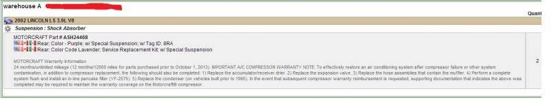

I have AT705G (front...this is not listed correctly on rockauto.com, they are listed as rears) and ASH24468 (rear)

For the rears, I ended up ordered ASH24468 off of rockauto.com listed under a 2002 LS. They worked fine and are indeed the sports, firmer than my old ones. I didn't copy the long part number off of the box, sorry.
