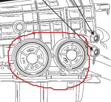

Hi!
Is there any trick to fully seat the servo cap covers?
it does not fully seat so i can't put the snap ring .
-The servo piston seats ok. OD & Interm
I try to put the cover on without the servo to see if was other problem but it does not seat completely.
Any tip ? :confused:
ty
best regards!
:cool:
Hi , ty for reply!
The cap cover for Overdrive & Intermediate servos.
Hi!
Now the cap cover are fully seated.
I push the cap with little taps until the snap ring entered completely.
ty!
