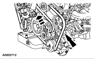

Hello again all...my serpentine belt...the one you can see in the front is fraying (I just noticed this when it started making a funky noise on my way home from work) I am parked at a friends and have to fix it...NOW so my question is what do I have to remove to do this any advice as always is much appreciated!!!

Anything that blocks access to the belt. IIRC just the intake plumbing.
Belt 3.0L
Removal
Remove the air cleaner outlet tube.
Rotate the tensioner counterclockwise and remove the drive belt.
Installation
CAUTION: Incorrect drive belt installation will cause premature drive belt failure. NOTE: Make sure the drive belt is correctly installed on each pulley. To install, reverse the removal procedure.
Refer to component locations-3.0L for correct drive belt routing.

These cars are cheap compared to women! I have the V6 also, easy replacement for the belt, just remove the intake after the air filter so you can reach down to the tensioner, insert rachet to relax spring, replace belt.
