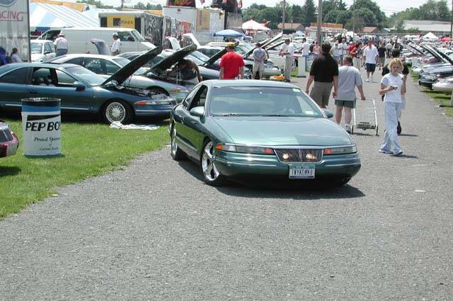

Here is what my old car with the 18's on it looked like sensor lowered, and also with my switch kit installed for that 'parking lot' stance.

yeah, those definitely look bigger than mine.......kinda weird how optical illusions work. what does the kit consist of? Is it alot harder to install? Did u have ray's(i think that's who i was told made em) kit?
