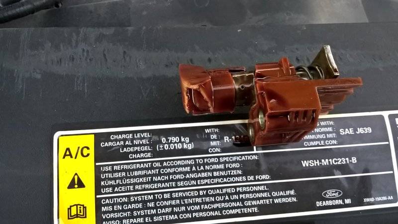

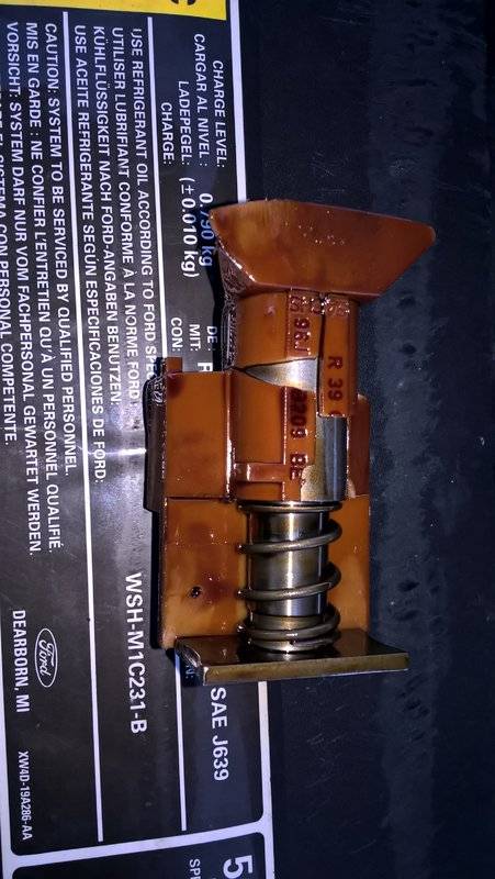

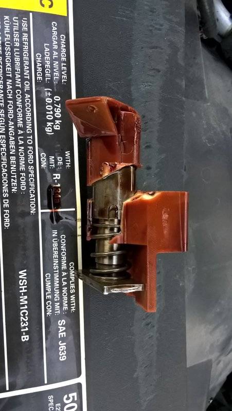

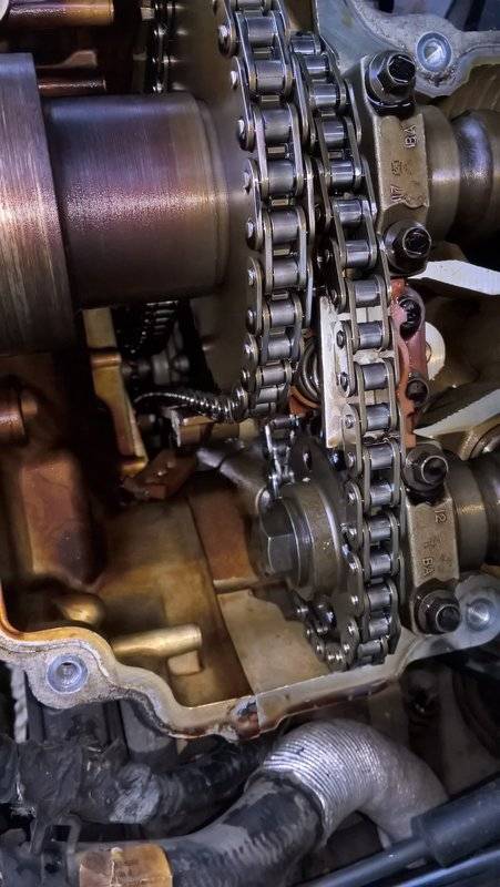

Have any of you seen a tensioner so utterly destroyed as this one? This is a '00 model with 180K. It was running perfect until coming home from work the other night. Drove about 40 miles and parked it for teardown. I was able to wiggle it out without removing the cam. I don't have the new parts in yet so I don't want to remove the cam just yet.
I expected the crack like everyone else shows. Imagine my shock!

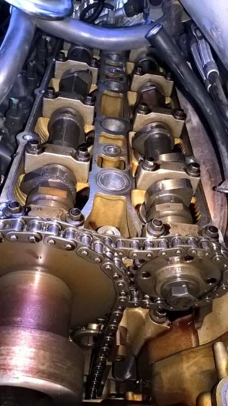

Also would like opinions on if the cam has jumped a tooth. I think it has. The car also ran like it had a dead miss.
Yes it has jumped time by one tooth.
Take note of the flats on the exhaust cam versus the intake cam. They are both not top flush at the same time as they should be.
Put a new secondary chain on.
Be sure to find all the disposed guide pieces.
GLWR

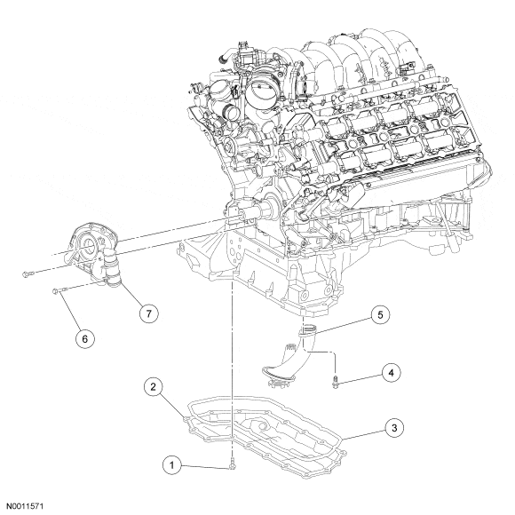

Thanks. My oil pan is beat to death, glad to have an excuse to swap it. Hope I can find it all. This thing is missing alot of pieces.
2nd GEN oil pan
Might be same as 1st GEN, can't be sure will I'm on the road. I have the 1st GEN shop manual on CD at home. Not with me.

I did the drivers side first, which is obviously more difficult. It wasn't bad though. Everything was easy to remove to make room. The cam came out and went back in easily, all the bolts went right back in too. All the coils looked new. I put in new spark plugs. The old ones were motorcraft with no evidence of oil or water in the plug wells, but evidence someone had done VCGs already. Putting the new VCGs in was tedious but easy. Torquing the cam was easy enough, the VCs are half torqued. I had to use a small ratchet so I just guessed. I recalibrated my hands every time I went back to the torque wrench so hopefully they aren't too far off.
The passenger side is where everything went sideways. Everything actually went great until it came time to reinstall the cam. Someone had monkeyed around with this side before. It had a good plastic tensioner in it. It had a broken bolt in the rear center of the VCG and the front cam cap upper bolt broke on the way back in.
After alot of cursing, totally removing the cam, a trip to town for the Easy-Out and a little bit of relocating items for getting a straight shot with the drill, I had them out. All the bolts had resistance when putting them in by hand whereas the drivers side ran all the way down easily so I chased every hole with a tap, it's M6x1 threads FYI. Stuck the cam back in and maaged to get it on the right tooth on the first shot. I replaced the front bolt with one that came from the old tensioner. I decided that the threads may have been stretched by a previous mechanic and that might be why they weren't exactly right, so I reinstalled the bolts with blue loctite. I hope that doesn't come back to bite me.
If you're using the cam tool none of this will be of issue to you.
Also, if you remove the cam, you'll probably want to snug up the middle cap and the one just to the rear of it first because those cam lobes are down and will be holding the cam up, I was afraid of getting the cam in a bind if I didn't snug them first and I mean snug, not torque :)
Don't be afraid to tackle this job, it's really not bad.

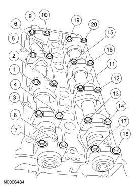

please tell me you followed this order,
Apply clean engine oil to the camshaft journals,
the camshaft caps and the camshaft lobes prior to installing the camshafts.
- Hand-tighten.
- Tighten to 6 Nm (53 lb-in).
- Tighten an additional 90 degrees.
I did the hand tighten alternating between 11/12 15/16 and the rest of them finger-tightened after the tension was released (Those cam lobes were down, holding the cam out, hand tightening them compressed lifters and seated the cam)
After that I torqued to 6Nm following that pattern, but mirror imaged. I started alternating the wrong way. As in I did 11/12 15/16 13/14 19/10 17/18. I hadn't seen that diagram prior to the job but I knew to start in the middle and work out.
EDIT: I didn't apply clean oil to the cam. On the drivers side it was only out of place for literally 10 seconds and on the passenger side I had sprayed it with fluid film while it was out and standing in my vice.
yeah ok, inwards outwards, should be ok.
