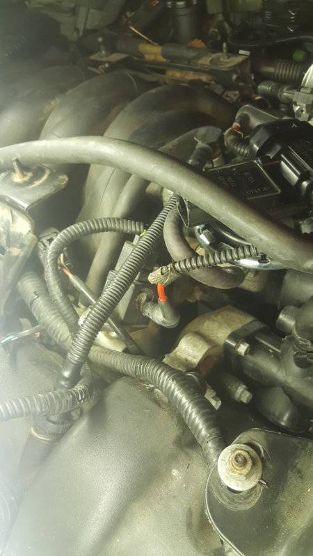

Also I accidently smashed a sensor or solenoid or something with a red tube coming off of it when I replaced the EGR valve . The same sorta red tubes that pluge into the EGR can anyone tell me what that is so I can replace that as well .

That sensor or something is probably the fuel pressure sensor. It won't really run without it. Also, the vacuum tube assembly that you mentioned is probably cracked.

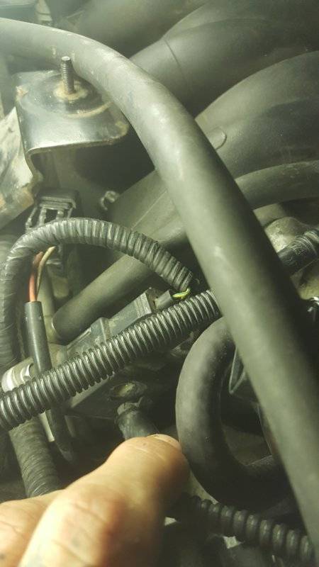

This is what I smashed when removing the EGR
Yep, fuel pressure sensor. Apparently, some aftermarket are okay and others are not.
I generally recommend removing that sensor before trying to remove or install the EGR valve exhaust connection. If the PCM does not know what the fuel pressure is, it can't regulate it or determine how long the keep the fuel injectors open. This can cause considerable operational problems.
