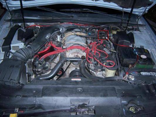

I've been having a pretty bad problem with my engine stumbling when warmed up and want to clean it out using some seafoam as I've heard its a good idea. I have a 1997 mark and want to clean her up. Which vacuum line do I pour the seafoam in and do I have to do any tuning afterwards because of the seafoam?
Next to the dip stick that is behind the steering wheel!
Actually when looking at the engine its in the top right corner of the car, and the line is coming off the left side of the booster going to the intake manafold.
Any chance at gettin a pic? I'm slow....need pictures. hahah

This is where you do it from. sorry if its bad quality, it from my phone
This is were I do it from. just remove that and suck it through there

Putting seafoam in a vacum line pulls it into the motor and it gets burned in the combustion chambers. What it is supposed to do is remove carbon build ups.
awesome you kick arse
I'll probably stick to the pcv since thats what the seafoam website says but just to clarify the brake booster line is a larger tube thats why its preferred?
It really doesn't matter what tube you use, the booster line is just very accesible on most cars, and does pull a lot of vacum. I bought a sweet funnel just for seafoaming cars, it go a super long taper that goes down to being thin enough to slide right into the hose.

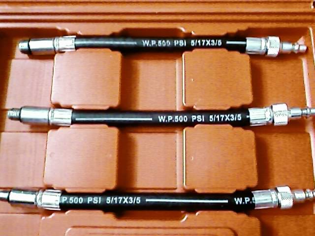

It's got a smoother idle and does sound a bit better if you ignore the misfire and what sounds like a clicking coming from the passenger side...kinda like this video on this thread http://www.lincolnvscadillac.com/showthread.php?t=41814 the you tube video...I got a compression test set although for some reason the damn hose doesn't want to screw in..Pretty sure its the right size check it out.
