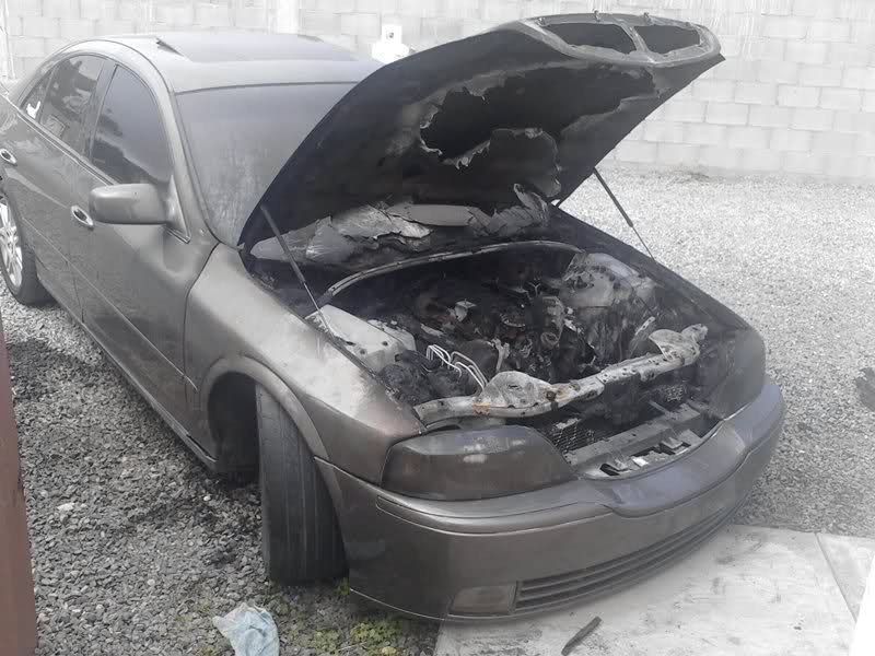

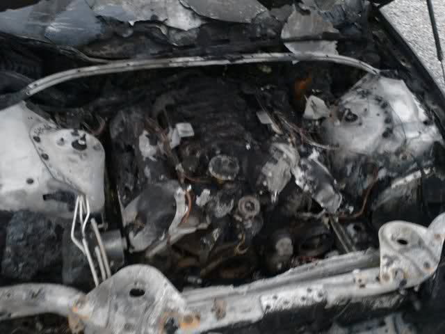

my 03 ls had a severe engine fire , and basically its way too expensive for me to repait it rigth now.

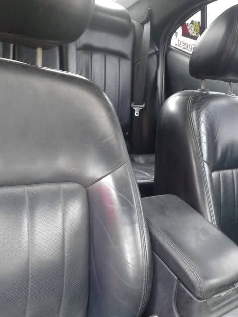

ill post pics of the interior in a few minutes

how does a power steering leak cause a fire? im curious so that i know and also what are the signs of a power steering leak (besides finding PS fluid on the ground)
If the trunk weatherstrip doesn't have any cracks or tears, I may want it. Maybe you could shoot me a PM on how much shipped to 02771
Get enough of it on something hot enough, like an exhaust manifold, and it will ignite. The same goes for transmission fluid (which is the power steering fluid in this and most cases), engine oil, and pretty much any petroleum based fluid in the vehicle.
Like Josh said, P/S fluid spraying on the exhaust manifold will ignite it. When mine sprung a leak years ago (fortunately under warranty) I was trailing a smoke cloud you wouldn't believe! It was IFR directly behind me! I went straight to the dealer and had it fixed 3 days later. It was the hose that connects to the pump at the fan and as it was new they had a devil of a time replacing it.
