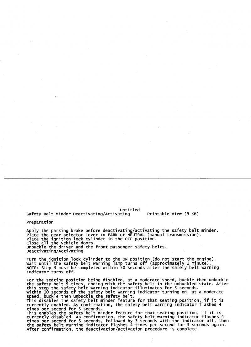

i hate the seat-belt warning buzzer and was happy to disable it !!
found the instructions on this site from a link someplace,didn't keep a record of it :)
turn the key on and buckle and unbuckle the seat belt nine times then the dash light flashes and buckle and unbuckle one time and that annoying warning buzzer shuts up !!!
do it again and it turns the alarm back on.
Now you can go on your way without that loud annoying noise telling you to fasten that damn seat belt !!!!
the light still comes on the dash but goes out silently and does not come back on after startup :)
sorry i couldn't find the original instructions again ... :(

tried to scan instructions.

Thats in the manual,,NOT super secret info..
THAT is "one time disable ""
Joe,,did you happen to read all the instructions i posted and understand the differences from your post ???
per what i posted is a permanent disable.
never have to do anything more.
no more buckling / unbuckling.
notice the instructions are WAY different,,for a reason :)
T...THAT is "one time disable ""

Ok,,i see that now.
the instructions differed a bit so i thought it applied to the one time disable.
the effort you put forth is outstanding Joe,,thank you.

Belt Minder chime Enable/Disable
Disable (mute) the cluster chime? ... and miss out on the ever so popular "mystery" beep

Can't space out reading material to discover it's sectioned "One time disable" vs. "Deactivating/activating the BeltMinder feature"
