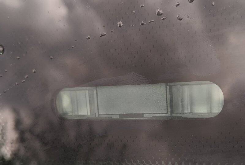

      As always, thanks for the awesome help guys! The compass sensor orientation is what I thought as well, but the tech on the phone assured me that the sensor was part of the mirror.
      I'll try to snap a picture of the rain sensor from the outside.

      Here's a picture of the rain sensor from the outside. Sorry about the angle and quality. It's the best I could get. Don't mind the minor fingerprint smudges. Those are from me just now trying to wipe away the rain.

      I can't tell from that pic if the pads are there. It was only obvious after I took it off and figured out the actual problem. Can you see if its at least lighting up amber outside? Might need some darkness to tell. Give the sensor box a light tug inside. Could be as simple as one side didn't clip in. It needs to make perfect contact

        They came out today and replaced the mirror, which fixed the compass issue. Also looked at the rain sensor, and the tech said that there were no pads on it at all. He put the pads on, and re-installed, but the rain-sensing was still not working. Guess I'm getting a new rain sensor as well now.
