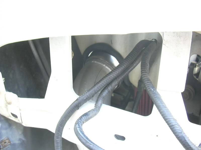

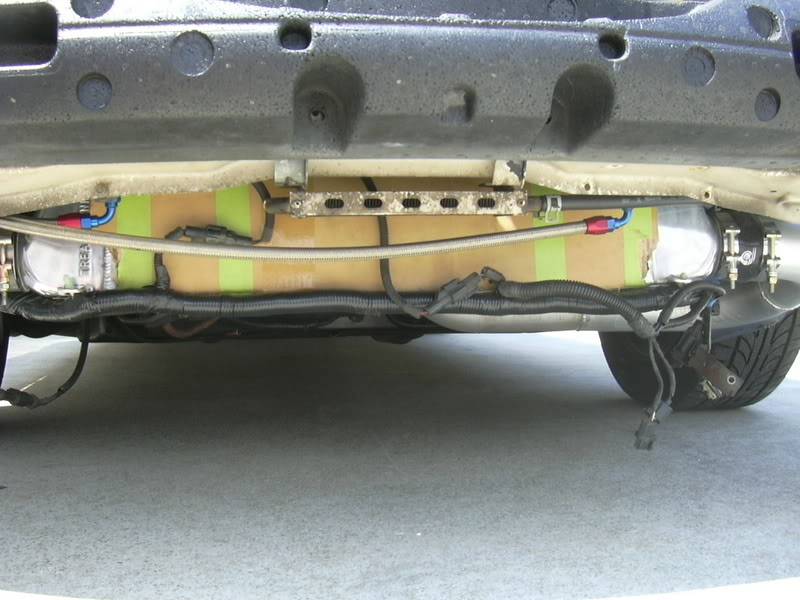

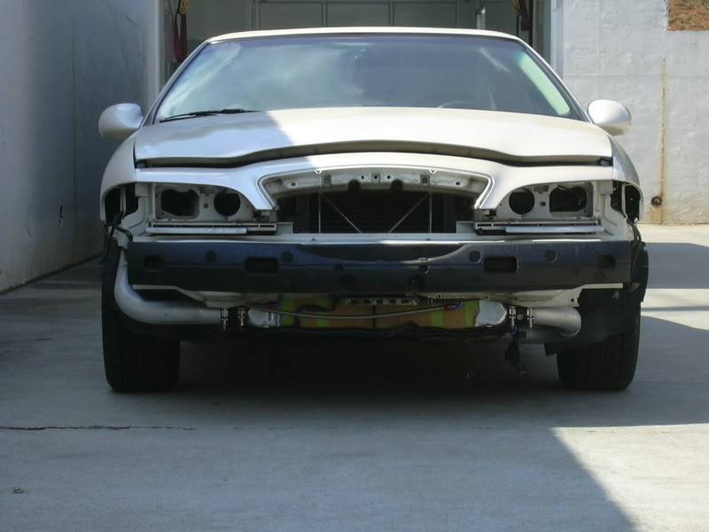

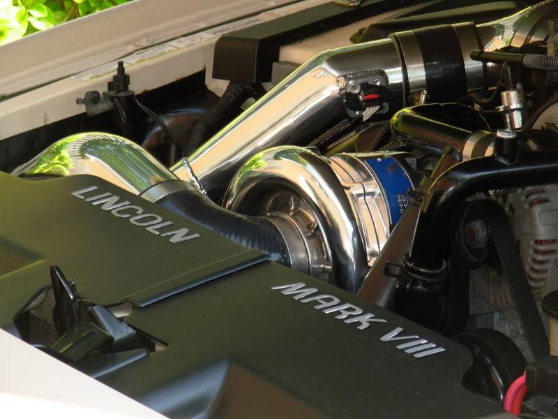

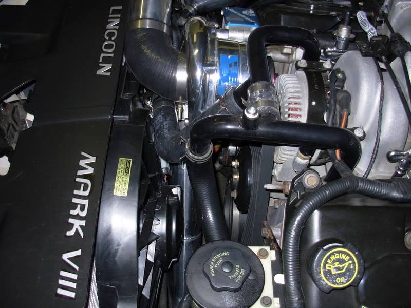

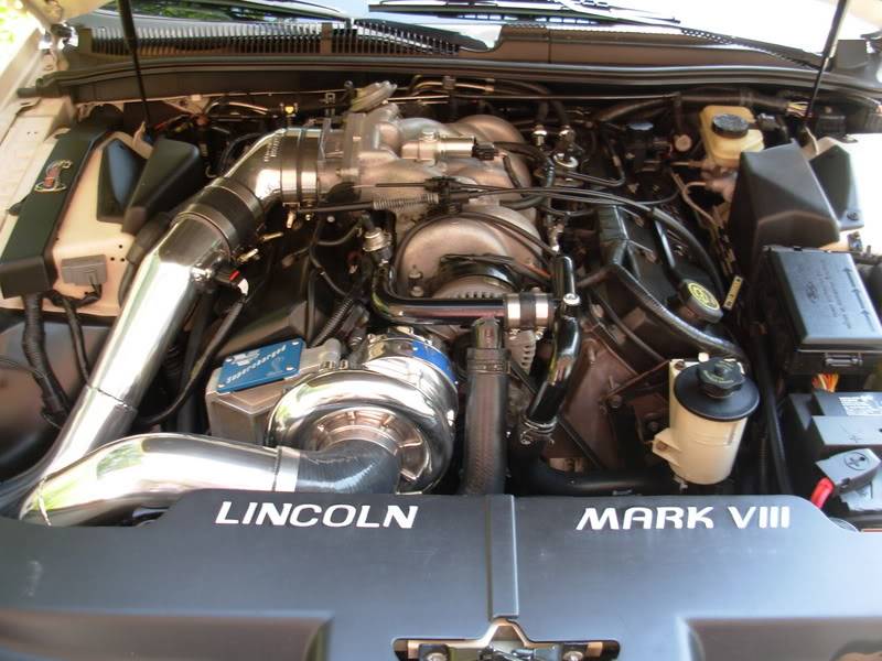

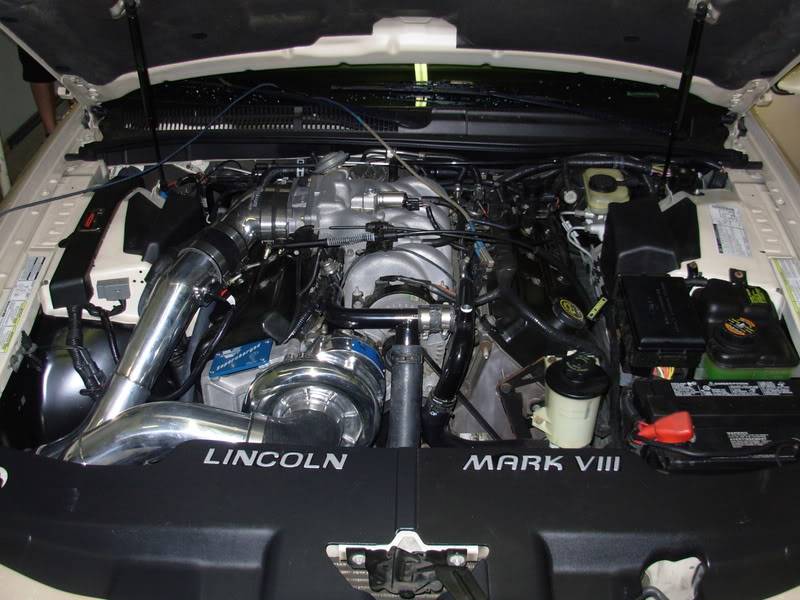

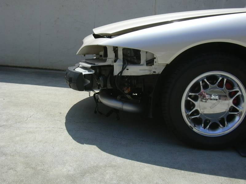

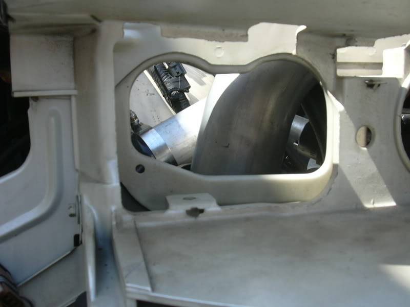

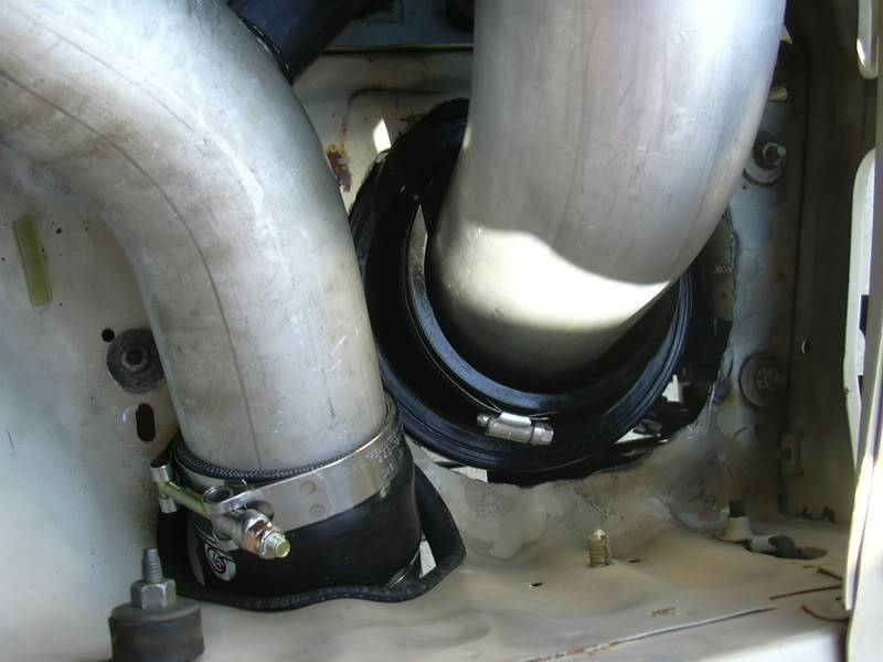

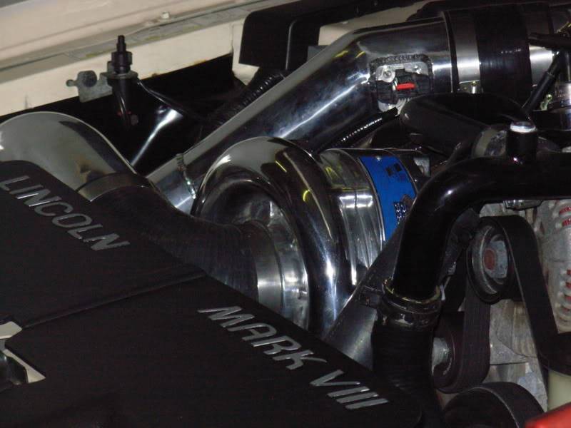

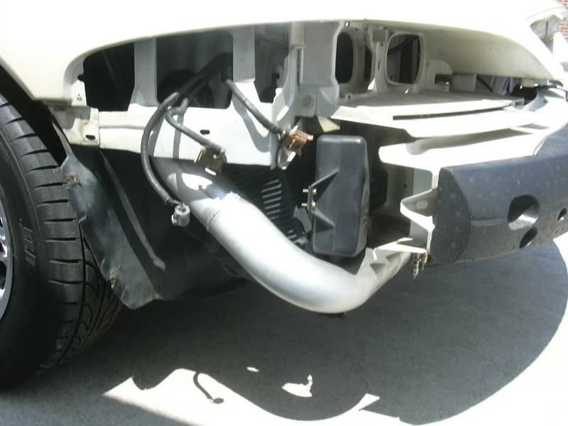

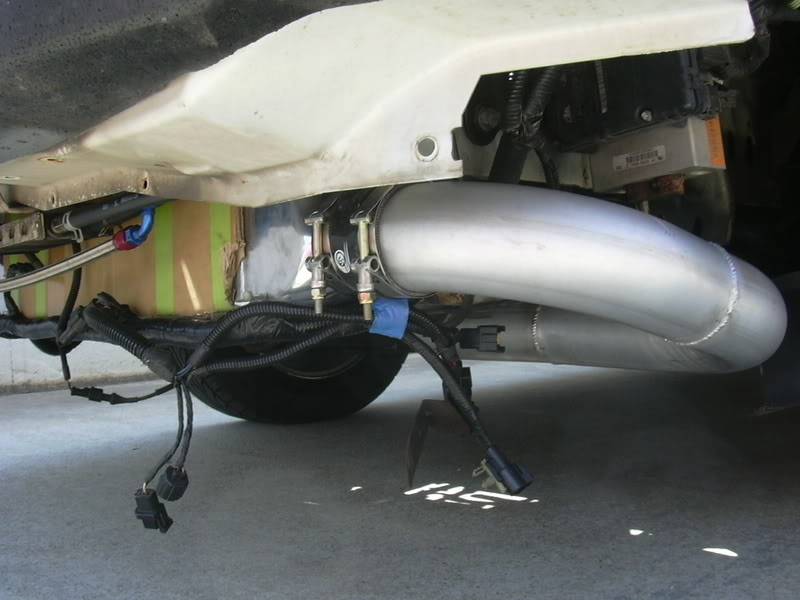

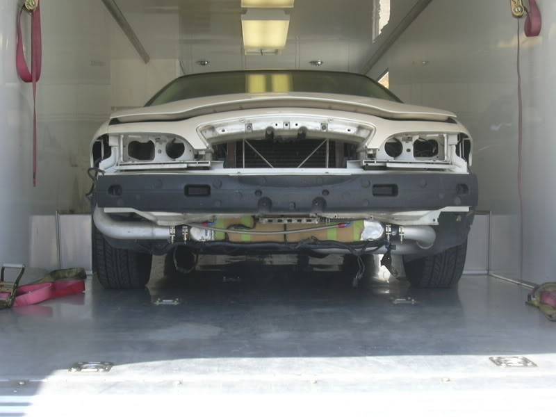

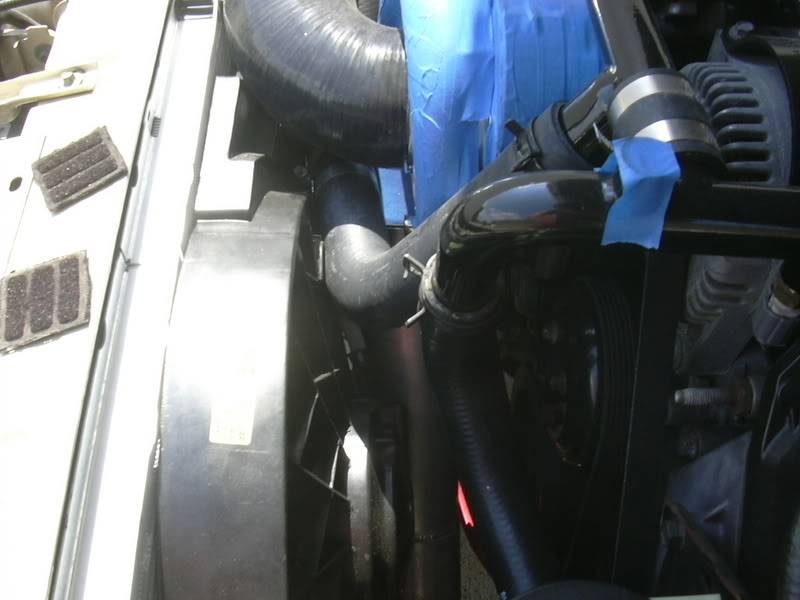

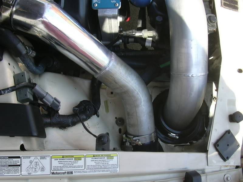

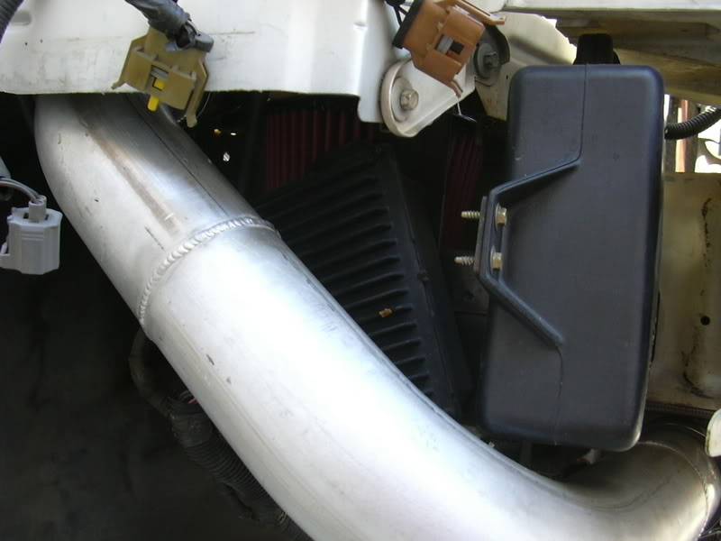

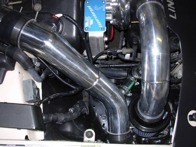

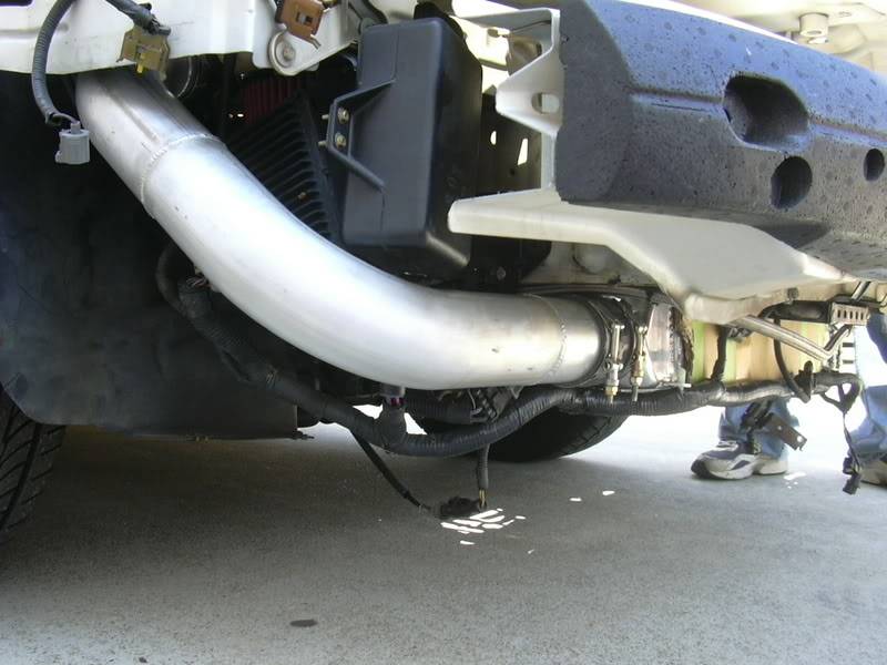

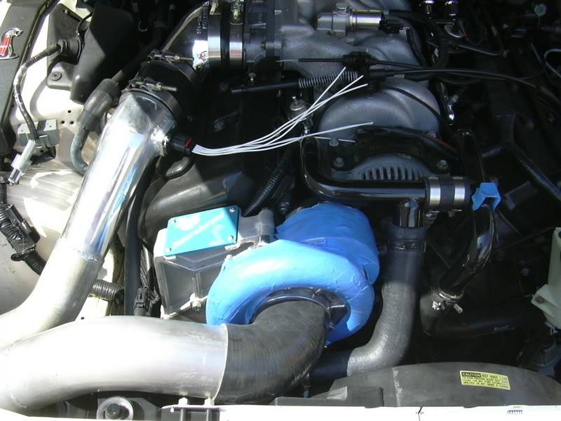

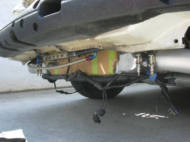

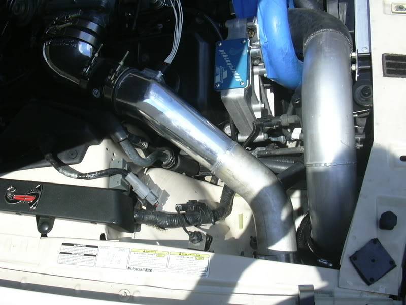

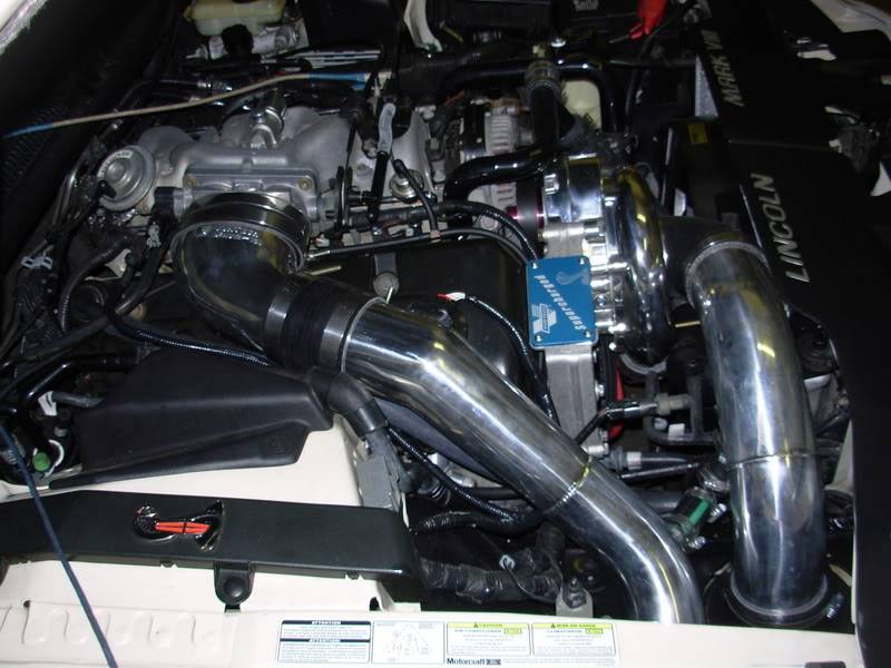

Here are some pictures of my original Vortech SC build showing some of the tube work involved for the air to air aftercooler. All custom made from scratch. Save yourself some money, and buy a Mark already SC modified ;)
Mrlandyacht- as you can see from the great pics Mike has submitted there is no easy kit fix that you can snap up and buy for the Mark Vlll. You also may have to consider what hoods are available also, although we already know that an Eaton will clear the Gen ll with some spacers under the cross member.
My advice to you would be to get your funding together and stop by Alternative Automotive and see Lidio to get you started in the direction you choose. He's more than qualified in either type of SC setup, and he's in your back yard.

thanx for those detailed pics mang.
