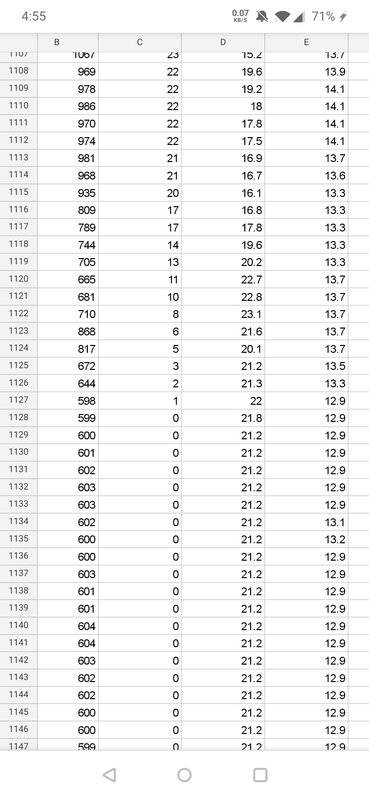

I have a 2005 ls sport, and my car surges forward when coming to a stop... usually around 10 mph. I have a blue driver odb2 tool, and looked at the live data. Below is the data, you can see the rpm jump without the throttle opening up. The car does not have a iacv and the fuel trim is usually negative
Rpm/mph/throttle position
809 17 13.3

Any ideas?

Hey guys thanks for the feedback so far. Still don't think it's the transmission. My first few post were from the mobile and I was a bit lazy. Let me try explaining again.
Problem: When slowing down I noticed the car would surge forward. This means the cars wheels would actually be putting down more power during that surge (rotating forward with force, not just coasting). This means I have to press on the brakes harder just for a second, until the rpm dropped back down (~1 second before I return to normal braking pressure). I noticed I would hear the engine rev during that surge of power, thus I started to look at the logs I posted.
What I checked: I originally assumed the throttle would open up as part of the IACV system (not an valve, just electronically controlled throttle to control the air flow), but the logs did not catch the throttle opening up, but did notice the rpm jump like I heard and saw on the dash.
Why it's not the transmission: I am familiar with the transmission downshifting and having a normal engine braking force. In that scenario the rpm can jump, but the car would actually lose speed, my issues is the opposite (car wants to gain speed).
Today I was able to test the transmission to make sure it was not late or hard shifts. I was manually shifting as my speed decreased (lets ignore the engine stress/rev matching concerns), and was able to put it into first gear (coasted for a bit and watched the rpm drop steady, so I know it was actually engaged in first gear) and braked normally, but the surge still occurred. This means the transmission was not causing the rpm jump.
Is it possible there is a vacuum leak, and o2 sensors detect a lean condition and throw more fuel at it which causes a bit more power and rpm jump? I also notice the fuel trim is usually negative. Any thoughts?
