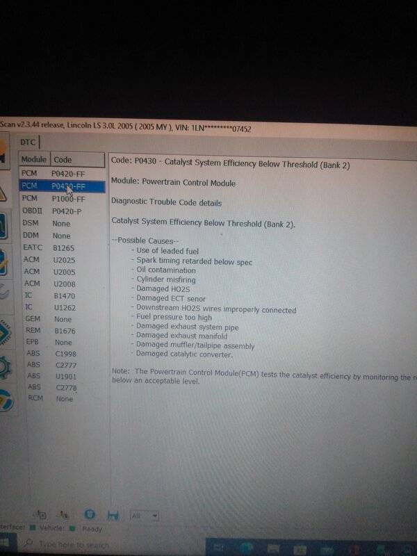

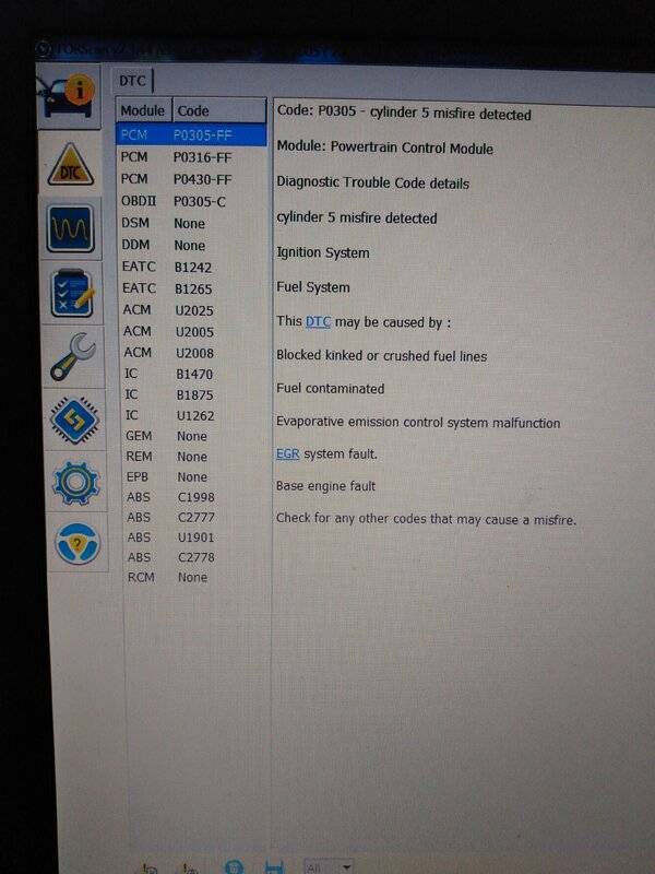

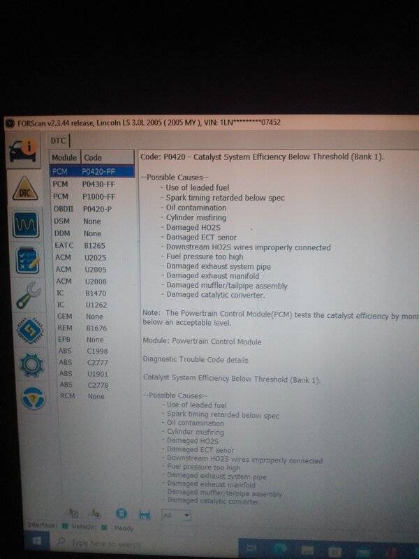

So as the topic says I'm having a rough idle at about 600rpm and lower then stalls intermittently
I used Forscan and these are all the codes that come up. Any help appreciated
Start with replacing the coil on cylinder 5, along with its spark plug. Luckily, it is the middle plug on the driver's side of the engine.

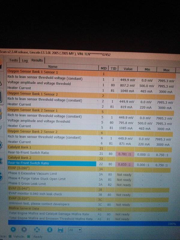

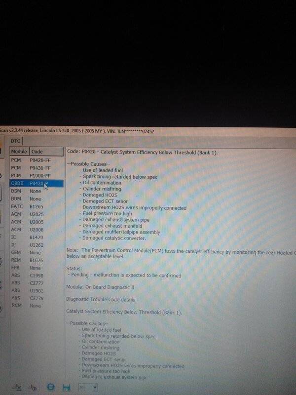

Turns out one of the intake manifold's bolts was snapped off so it was loose, oil everywhere even on the spark plugs and coil boot was bad on a COP. Also pigtail to throttle body was broken.. everything got cleaned, bored out the bolt, changed spark plugs, new pigtail, new upper and lower gaskets and changed all the injectors running a lot smoother now but still showing cat efficiency below on bank 1 and 2
