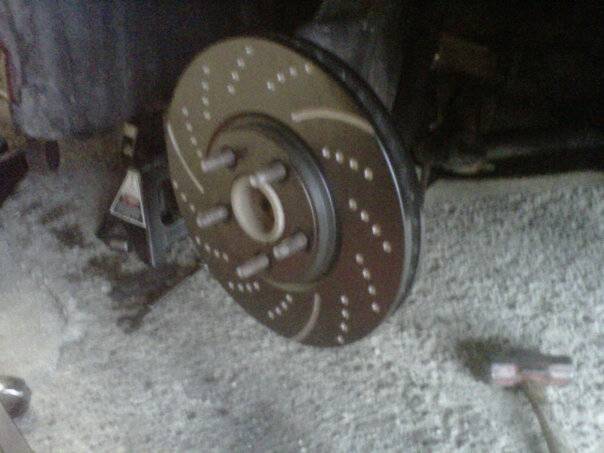

thats what i put on the front with red stuff pads.... generally awesome stopping power and consistency. i would highly recommend them if the money is available.
i did notice mine are not exactly the same as in the pic, i have the slotted and dimpled rotors. i piced them up at my friendly neighborhood summit racing, man i love that part of ne ohio
Bought the rotors from a1 knoncepts in CA off ebay and was scared at the price. They were cheaper for all 4 with shiping then one OEM or two from local aftermarket dealers. I have had them on for over two years now and they are still in perfect shape. Not sure how they do it. If I had rims that were more open I would go with OEM. They do show a little rust on non braking areas.
wow those are beautiful.....so how visible is the rust on them now.
i like these more than the rotor pros ones.....
there is no rust at all, i love them the only rust i get is on the stopping surface if it rains over night or at work but thats to be expected from any rotor. no rust int the dimples or slots i love thm
i get a lot off people look at em like whoa, you have drilled and slotted rotors? i think there pretty normal but apparently not. Mercedes AMG's come standard with em
