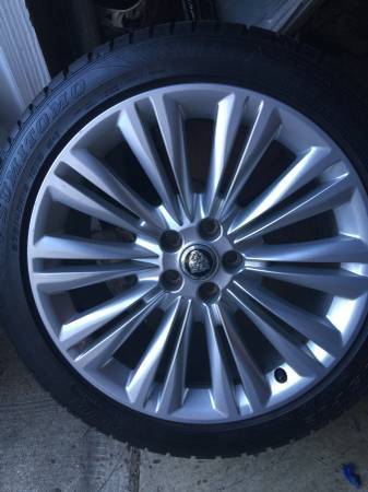

Found a set of jaguar staggered rims. I have read all the posts and even though I know the awnswer I still feel the need to ask. They are 19x8.5 front and 19x9.5 backs. I wasn't sure if anyone has ever tried a spacer on the back to make the offset work. They are Caravela Rims and I an not sure of the off set. Any help would be great. I have to replace my tires and I'd like to update the look with rims if possible. Already going to invest around 700 so looking for a rim and tire deal.

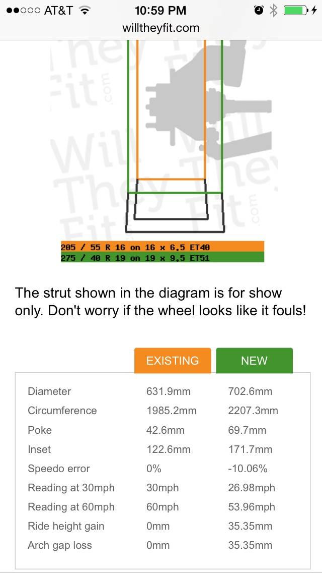

In order to get a better idea of the fitment you need wheel width AND offset. In general, the lower the et (offset), the farther the wheel sticks out relative to the body of the car. Wheels with a high offset (et60 for example) tuck in more.
http://www.lincolnvscadillac.com/forum/showthread.php?83591-Wheels-101
Two wheels with identical widths, but offsets of et35 and et60. The et35 will stick out more by roughly 25mm. When you change to a wider wheel and a lower offset you are moving outward for two reasons, the mounting surface of the wheel is moving closer to the center line of the wheel, and the wheel itself is becoming wider.
Willtheyfit.com is a great resource for typing in stock wheel specs and the new desired wheel. I also like to measure the distance between face of the wheel and outer fender of my stock setup, before committing to a a new wheel to get a feel for how much room I have to move out. I want to say the limit is around et35 on a 9.5" wheel for the LS. Based on the jagwheel fitment thread.

Thanks for all the info. The rim and tire are jaguar caravela rims.
Staggered setup 8.5 front and 9.5 rear rims with 245 40 19 and 275 40 19 tires.
I measured the added dimensions and it look like it would fit but I am not sure if it will rub once on the road.image.jpg

I measured the added dimensions and it look like it would fit but I am not sure if it will rub once on the road.View attachment 828475611
Might fit but a 10% differential is waaaaaaaaaaaaay too much! You want no more than 3%. And the car will be ~1 1/2" higher!!!

NO.... The overall circumference difference is too large!! Find an online wheel calculator to see what sizes will work.

The larger the wheel the smaller/shorter the sidewall needs to be to get close to the factory 26.3" circumference. I'm running a 255/40/18 tire/wheel o my wife's LS.
