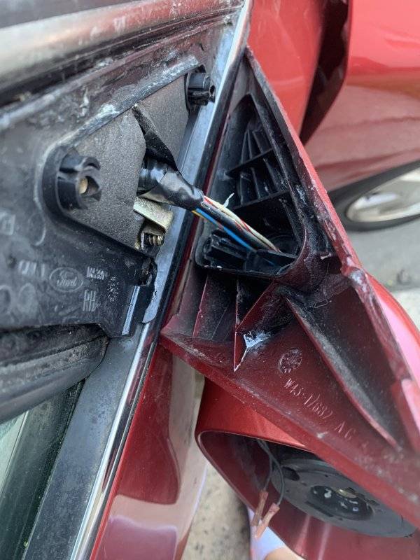

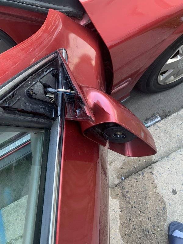

Looking to replace my mirror but need your guys help!!??

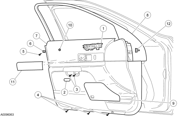

Take your interior door panel off ...
Front Door Trim Panel Printable View (83 KB)
Item Part Number Description
1 14528A Window regulator control switch panel assembly
2 22670 Door trim panel handle screw cover
3 S5929 Door trim panel handle screws (2 required)
4 N806555 Door trim panel screws (3 required)
5 S5929 Door trim panel screw
6 67841 Screw grommet
7 23942/23943 Front door trim panel (LH/RH)
8 20890/20891 Front door window garnish moulding (LH/RH)
9 601B48/601B49 Speaker grille (LH/RH)
10 — Door trim panel applique nut
11 20942/20943 Door trim panel applique (LH/RH)
12 2W4254 Door trim panel pin-type retainers (9 required)
Removal and Installation
  1. Disconnect the battery. For additional information, refer to Section 414-01 .
  1. Remove the window regulator control switch panel asembly.
    • Disconnect the electrical connectors.
  1. Remove the interior door handle cover, and the 2 screws.
  1. NOTE: Using a suitable tool, insert 2-3 mm (0.78-0.118 in) and rotate to disengage the snap feature.
    Remove the door trim panel handle screw cover, and the 2 door trim panel screws.
  1. Remove the 4 screws and the front door trim panel.
  1. To install, reverse the removal procedure.
