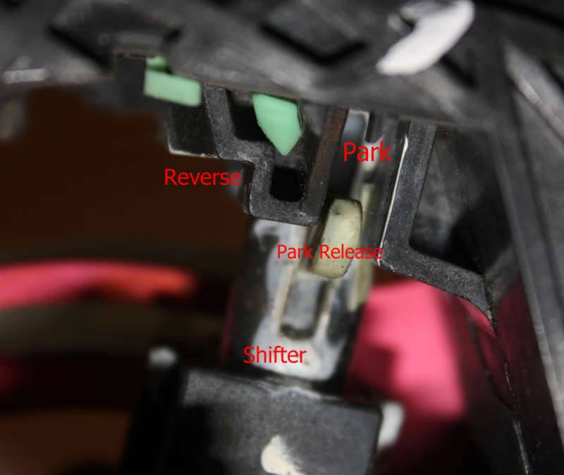

I just thought of one other thing--the problem may be in the shifter itself. The button on the shifter pushes a rod down to disengage a bar from a detent in the shifter assembly; if it doesn't push the lever far enough, you'd sure enough have problems shifting into and out of Park, but not with any other shifting.
In the picture below you should see what I'm describing. The arched black piece at the top of the picture is the underside of the top of the shifter assembly, and you can see the white bar not quite disengaged from the detent. The slot is the Park position, and the next step down (to the left) is the Reverse position. You can see that the "hump" between Park and Reverse is the highest in the assembly.
I haven't disassembled the shifter rod, so I don't know how the internal linkage works, but if you've recently removed the shifter knob, it might not be seated down far enough to fully move that bar...
Edit: for some reason, the image is upside down. The white bar should be below the black arch...
Edit 2: Wait, not, it's not. I inverted the image on Photobucket (the original was taken upside down for lighting reasons), so I must have had the original image cached. Never mind...
Edit 3: Added text tags to the image to make it more clear-er. ;)

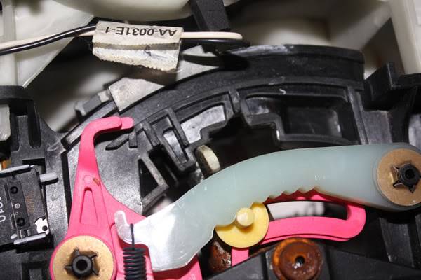

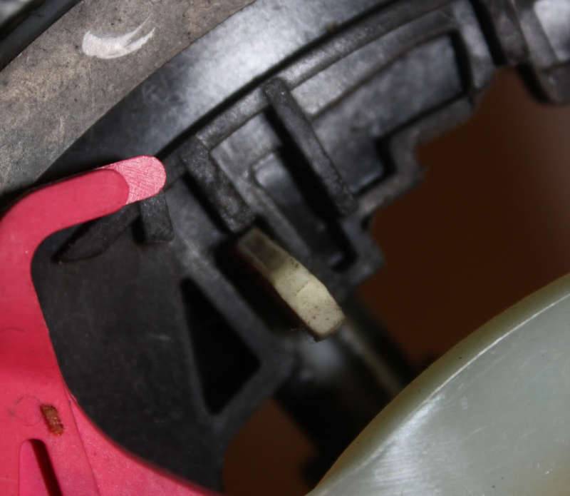

It's from the passenger side. The driver's side has the same detents, but it's a bit more cluttered (the brake pedal interlock mechanism--the fuzzy pink piece visible in the background--is on the driver's side).
Here's a shot from the driver's side with a bit more context. Note that the shifter is in Reverse in this picture.

Thanks for the pics I was going to ask if I should mirror that one.
Also, note that those are pictures of a 2nd Gen SST shifter. I don't know if things are different on the 1st Gen shifters.
