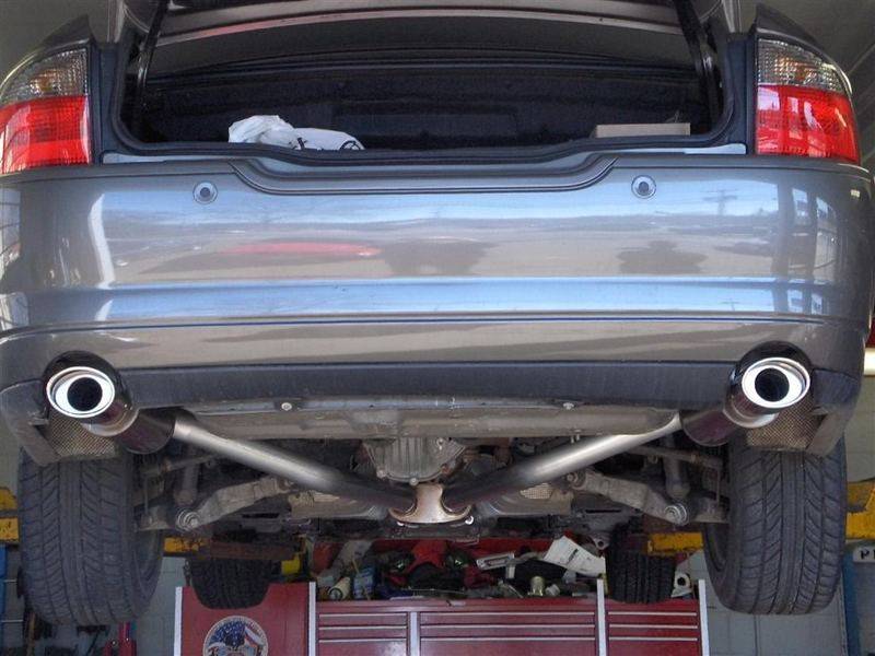

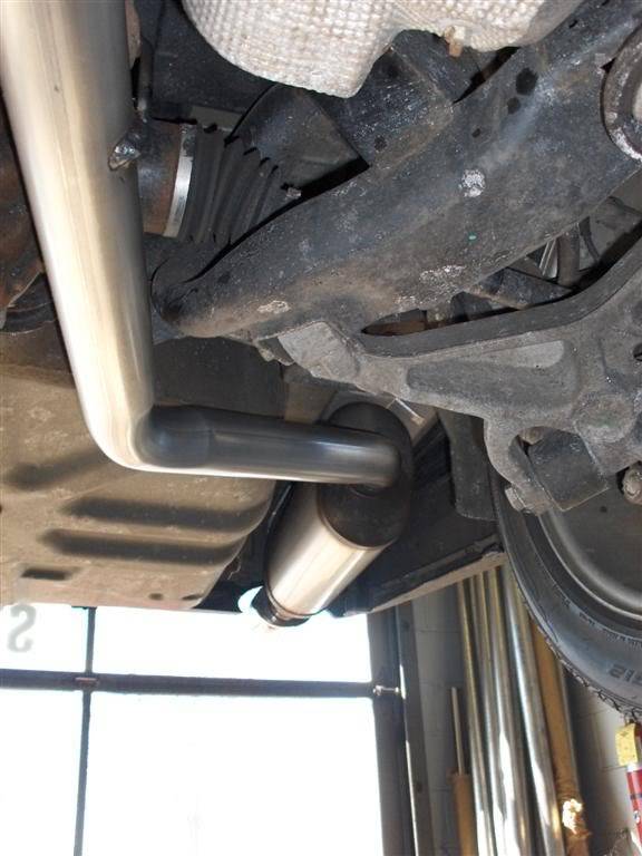

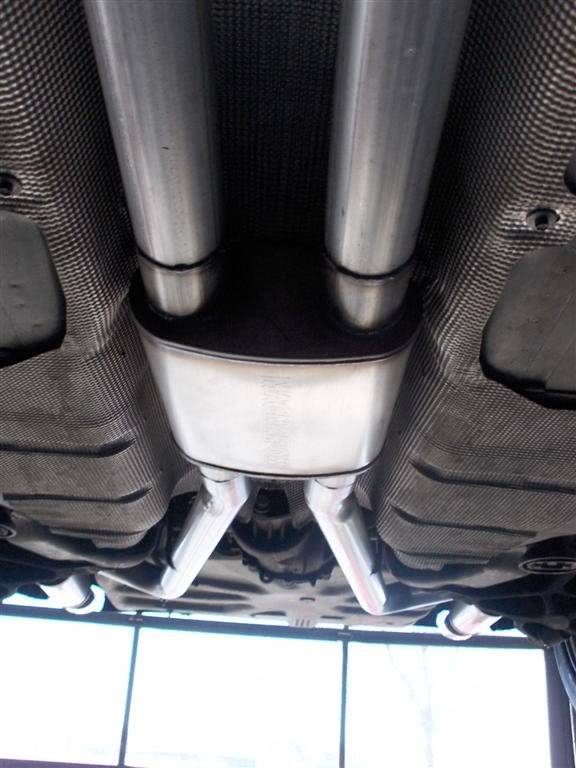

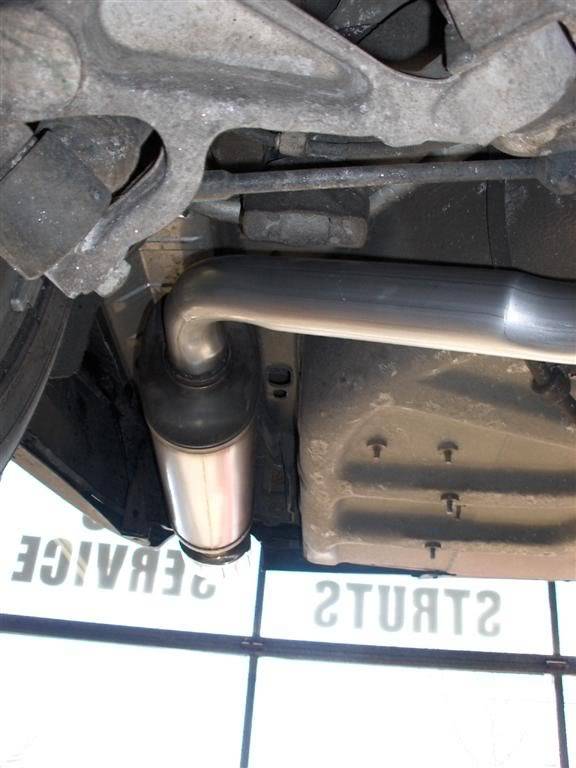

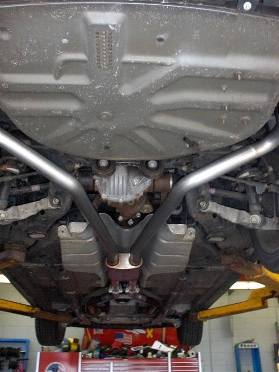

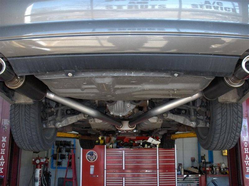

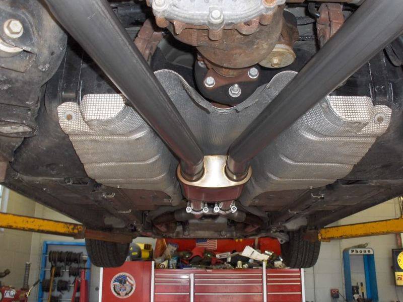

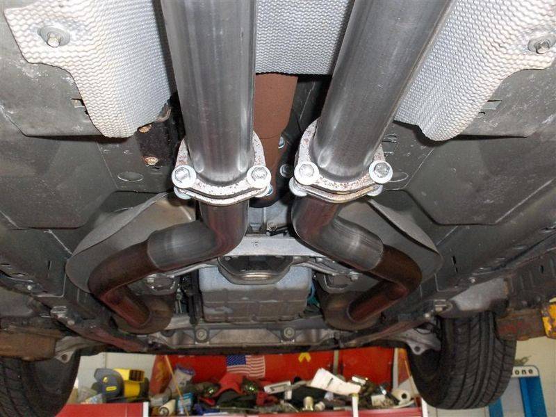

Here's the first exhaust set-up I had. In the last picture, you can see towards the front of the car that the stock piping there is NOT 2.5". The custom pipes are.
NYC - thanks for all the pics (and sorry for the hassle that you had to do it). So does the exhaust have one muffler in the middle of the system that both pipes go into, and then 2 resonators at the very back? Trying to understand what I'll need to replace.
Will an exhaust shop be able to salvage/use the existing pipes, or will I have to have new pipes run if I just replace the mufflers/resonators/whatever else I'm missing?
Thanks again,
TRU - exhausted (pun intended)
In that picture, I went with three mufflers. The one in the middle is a dual in/dual out Magnaflow (and replaces the stock resonators), with a Magnaflow muffler at each rear corner of the car.
After these pics, an X pipe was put in.
Then I removed the middle muffler and added a second X pipe.
Then I removed the second X pipe and put in Aero Turbine resonators where the middle muffler is in the pics above and removed the rear Magnaflows for some Bassani mufflers.
Don't have any newer pics of the set-up how it is now, though.
