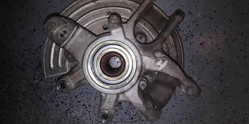

After much struggle pulling the spindle off the axle, here's the knuckle with the bad bearing

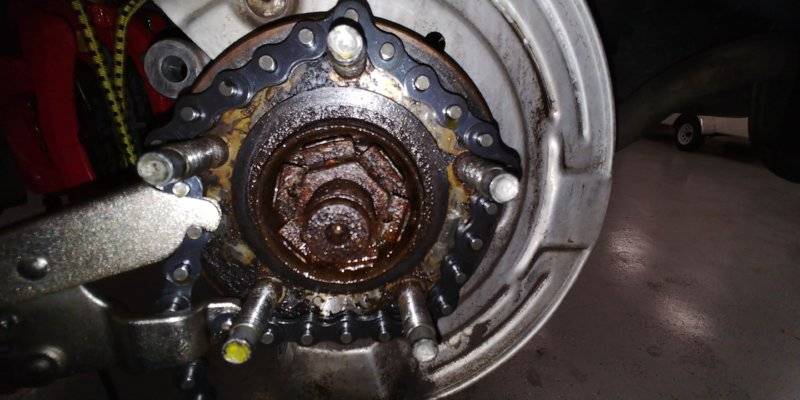

And here's what you see with the knuckle off - you can see the serrated ring for the anti-lock break sensor to sense wheel rotation (or not)

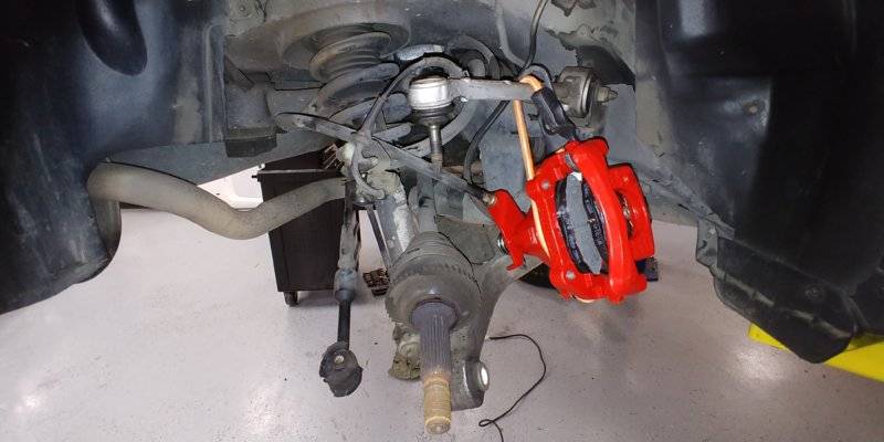

I ended up taking both knuckles off of the car. With one wheel bearing definitely bad, I figured the other may not be too far behind.

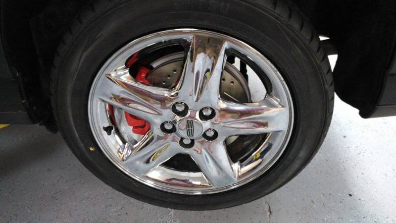

Finally here's the new tire on the car with new caliper, rotor, brake pads and rear wheel bearing. Now over to the other side of the car!
