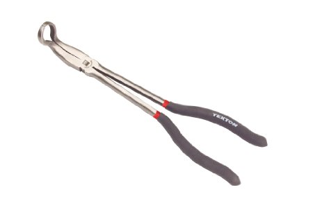

Updating thread in case anyone has trouble loosing broken fuel line quick connects on the fuel pump. This thread was useful in understanding how to release the tab with the top of the connector broke. All you need to do is keep the little red ring pushed down while trying to pull the hose out of the connector. My tabs were still in tact but pushing them in wouldn't loosen the hose so I broke it off so I could have more access to the red ring. I used hose pliers to push down the little red fitting, the angle allowed pressure to be applied on both sides.
