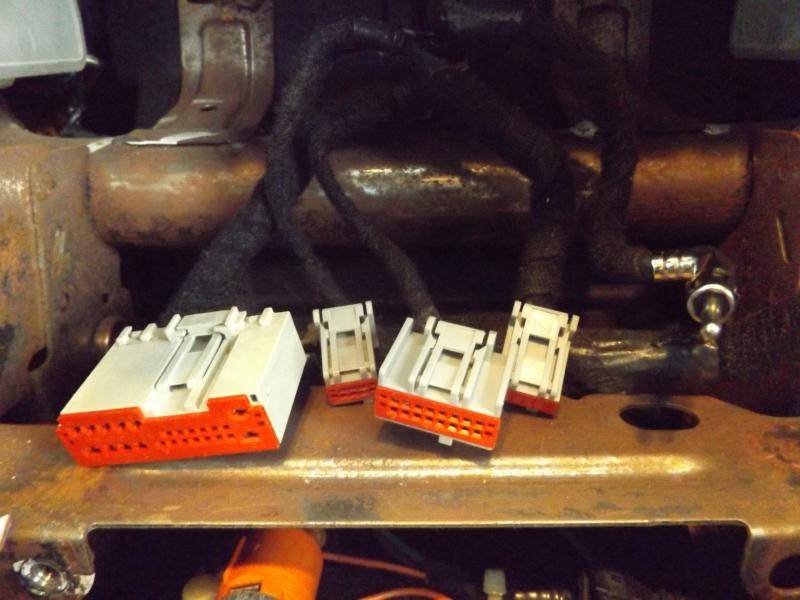

I have the SoundMark Band so this cannot be replaced with an aftermarket stereo system? I the pics these are the four wires from the back of the factory stereo. I want to replace the factory would the Kenwood stereo...is it possible to do?? Thank you.

The factory radios are more interchangeable than has been implied, but there are limits.
All factory systems can be replaced by aftermarket. Off-the-shelf plug-n-play harness adapters exist for all with the exception of the THX navigation systems. (These can be replaced by aftermarket too, but there is no simple harness adapter for these.)
Anyway, there are two different wiring schemes. One for gen I (2000-2002) and some of the 2003 gen IIs. The other style is for gen II (2003-2006), but some 2003s are an exception to this.
DUVALINCOLN needs the gen II adapters, and his picture shows the gen II connectors.
Sure, changing the Head Unit for an aftermarket unit is always an option.
Sure, changing the Head Unit for an aftermarket unit is always an option. What the OP is missing here is that the Head Unit and the HVAC Control Unit are separate; they both are mounted to the same bracket but that is all. Two of those plugs are for the Audio, two are for the HVAC.

Yes, the DATC and the radio are separate, they just mount to the same bracket.
Yes, the DATC has two connectors.
No, none of the connectors shown in the picture are for the DATC. Those four connectors (plus the antenna connector) are all for the radio that he has.

All great information. I was able to order a wiring harness offline and it only came with parts like most of the ones I have found online for the 204 Lincoln Ls. My question is what are the two remaining wires for and are they needed? ThanksDSCF6159.jpg
All great information. I was able to order a wiring harness offline and it only came with parts like most of the ones I have found online for the 204 Lincoln Ls. My question is what are the two remaining wires for and are they needed? Thanks...
The big connector is power and speakers. The 8-pin one is the subs and center channel. The other two have connections for the CAN bus (this is how it knows what display brightness to use and when the door is opened), the Ford data bus, phone integration, satellite radio, and so on.

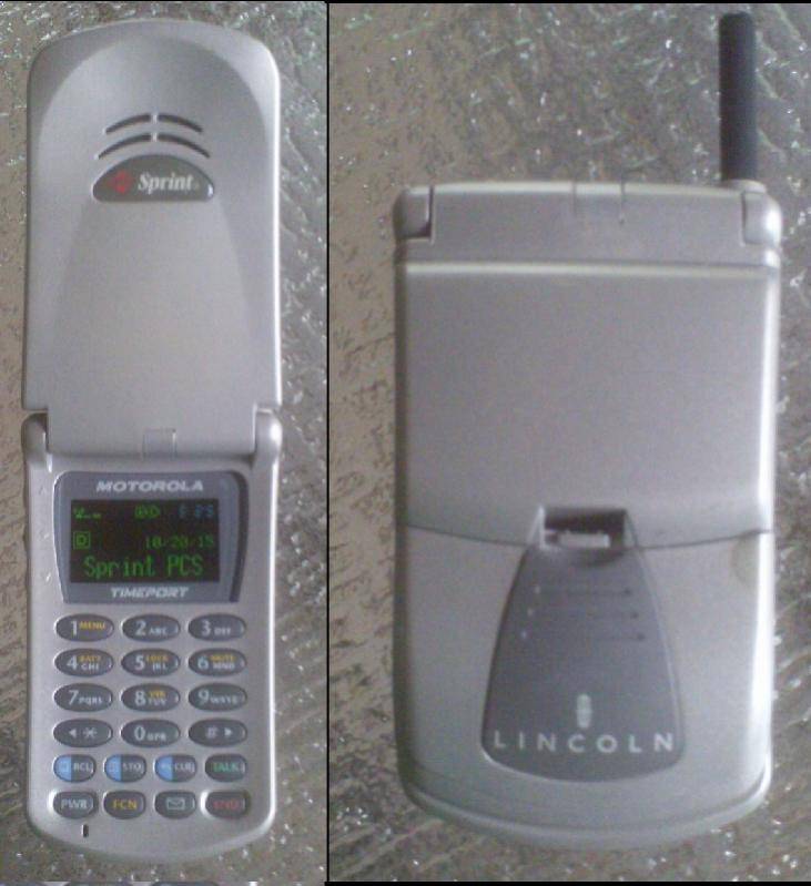

My 2002 has an integrated factory (Sprint) Cell Phone. Even branded as Lincoln. It's in the Console and swings upward. I haven't activated it as I already have two cell phones and really don't need a third.

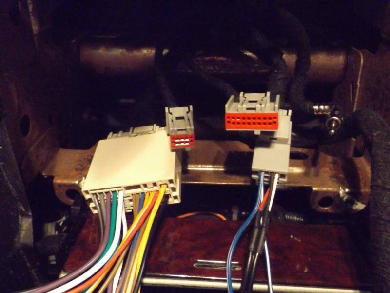

Great info. so since I have wire connectors for the two main factor stereo connectors, do I need to find connectors for the remaining two orange ones shown in the middle as seen in the last picture???
Nope. They wouldn't do anything at all for an aftermarket unit. Just tape over the ends and poke them out of the way.
