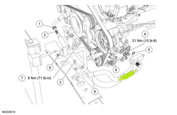

Ok. The Hose Assembly with the Low Side Service port is covered in UV dye that I had the shop impregnate into the system last summer with a full refill of R-134. The leak appears to be where the braided section of the hose meets a metal part of the hose. Upstream from this point the metal and other hose parts look clean. The system currently has 0.2lbs of freon in it.

I went in to the shop to have them refill it again, or first check the freon level on it because it wasn't cooling. He had it hooked up to a machine about the size of a small refrigerator then told me it measured at 0.2 pounds and that there was no point in putting any freon in it, as it would just leak again. With a flashlight we could see the dirty sticky area of the hose. Although I have not laid my eyes on the compressor to validate that it was completely clean or that there was no leaks in the immediate area, I could see that the metal section of the hose assembly before the hose (towards the compressor) appeared clean.
Here is a picture of where I see the contamination:
