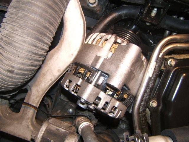

thanks for help guys,
after about 1/2 hour of disassembling everything, and about another three hours of trying to squeeze it out of the space they leave you to replace this thing, I finally got it changed out,
good job. did you use a motorcraft alternator or something else?
yep - it's funny - when you finally get it positioned correctly it falls out....
