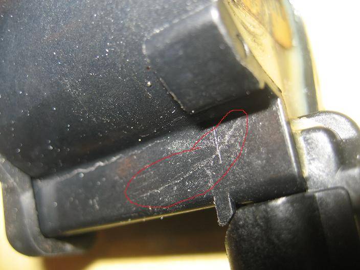

That was the problem that was giving me the same issue. A hairline crack. It took me about $250 investing in an Autotap setup that diagnosed the low misfires, this particular coil was misfiring about every 2 seconds. I always wanted the Autotap scanner, so this was a good excuse to buy it LOL Ford wanted to charge me $109 for the scan one time.
You can refer to my thread at:
http://www.lincolnvscadillac.com/showthread.php?t=45573
