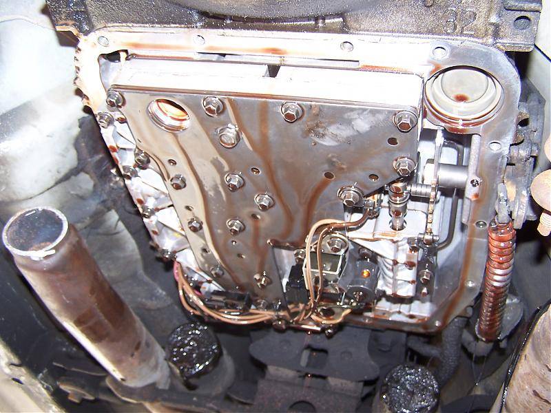

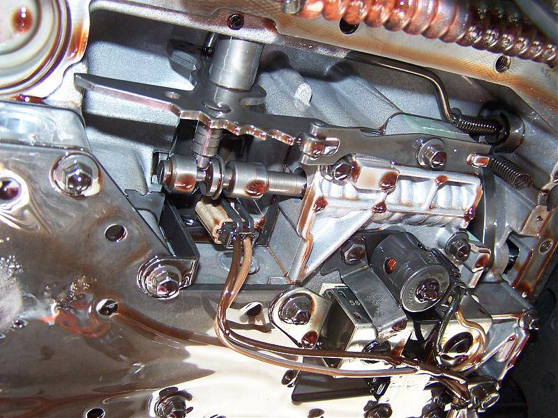

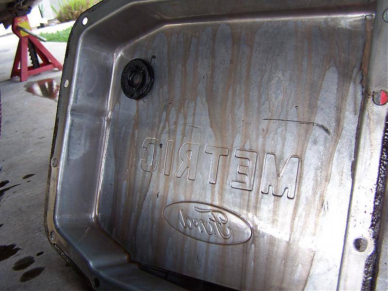

The good news is the oil smelled like Merc five and it was super clean inside, heres a couple pics....

Looks like a fairly clean tranny, not that I've seen many trannies in my day! I hear KK likes to mess around with trannies every now and then. Clean, dirty, it doesn't matter to him!
LOL, ya its the real clean ones that can fool ya, It all looks good until you get to the inside :eek: I hope he'd notice before it was too late.
