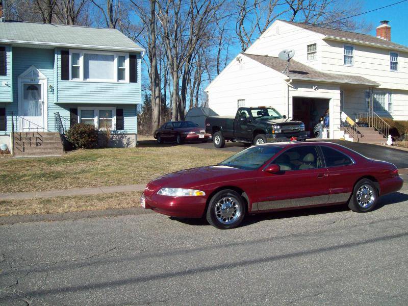

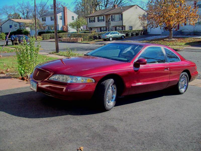

I removed that crap chrome from the lower part on my 98. I just used a heat gun. a plastic puddy knife, and pliers. Don't get it too hot or you could blister the paint. I had a few small places it messed up. Once you get it started pull with pliers slowly. Mine curled as I removed it. Just like opening an old style can of tuna. It looks so much better after it's off. Take it to a scrap yard and get some $$$$ for it.
