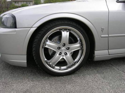

I was able to get the headlights apart with a dremel cutting disk. I then took out the amber lenses and painted them silver to match my car. I also added angel eyes while I was in there.

looks very nice man. i dont know if i want to go cutting on the old girl tho.. gonna have to think about if its worth it.
