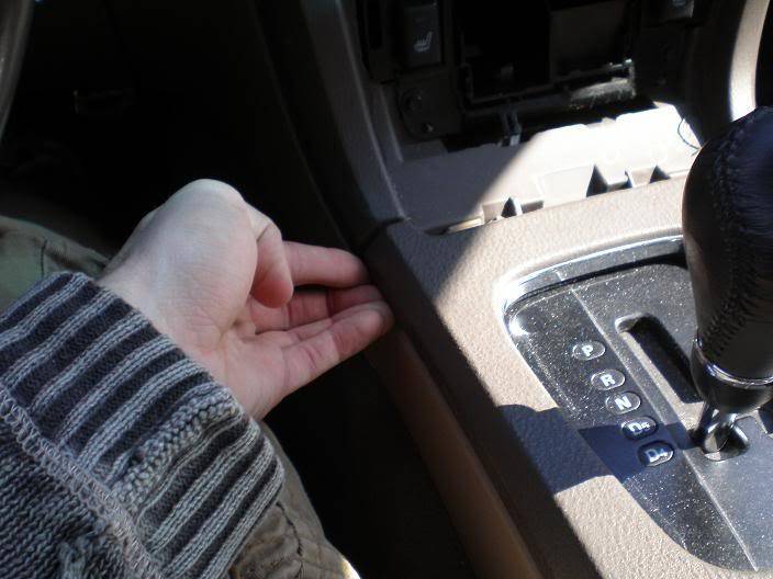

I'll run out and take some pics of taking mine off real quick...
First, remove the ashtray. Open it, and push up from the bottom of the woodgrain:

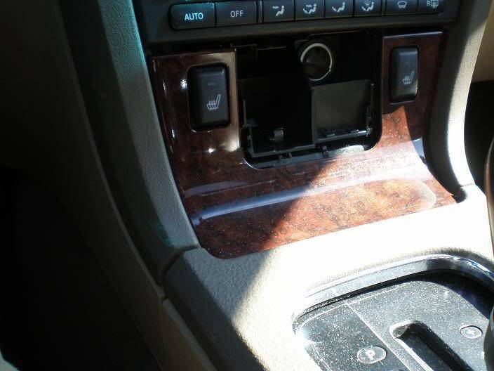

Second, push the ashtray closed:

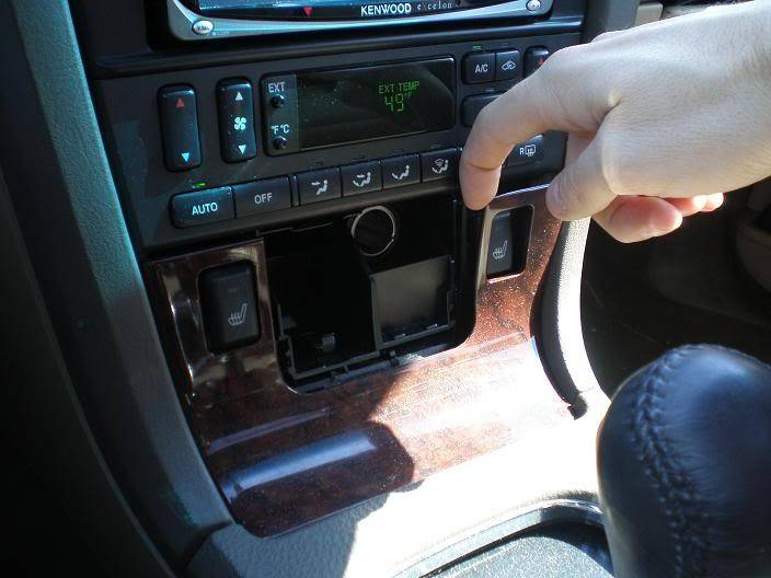

Third, pull gently from the top of the woodgrain to release one clip behind:

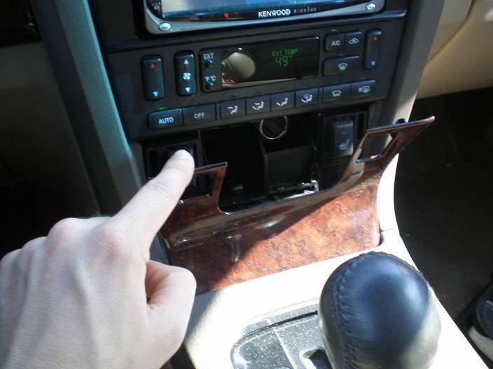

Four, repeat to release clip on other side:
Fifth, Remove woodgrain piece. Figured this step didn't need a pic :D

actually dont have to remove the ashtray. You can place a skinny flathead where his finger is in pic #3, and carefully pry down and out, and that woodgrain piece will pop right out.
