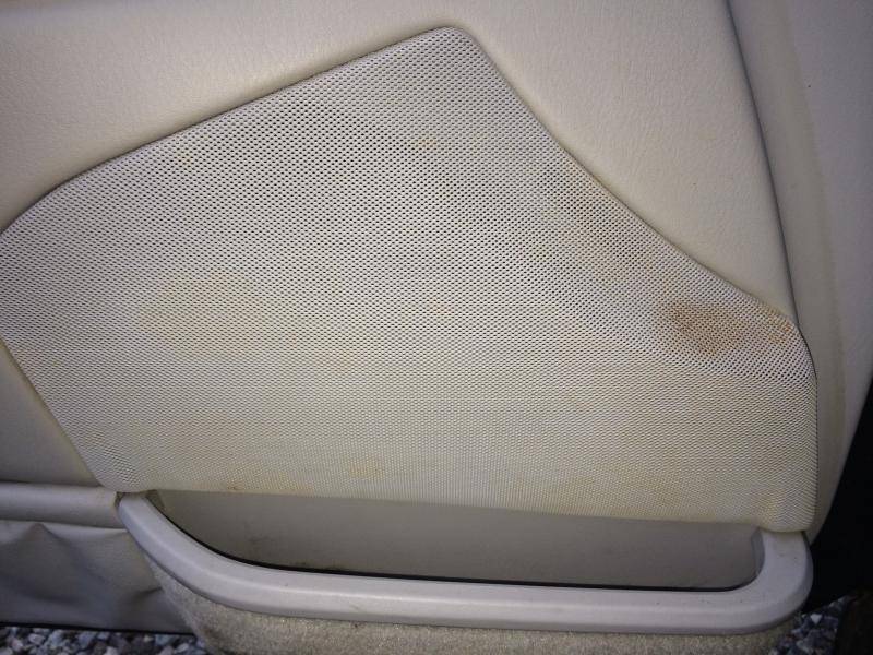

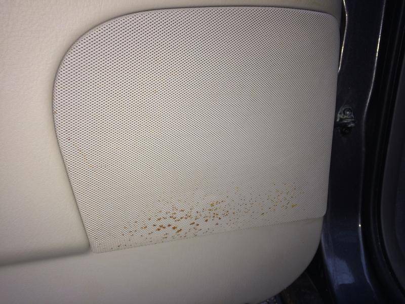

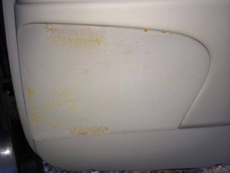

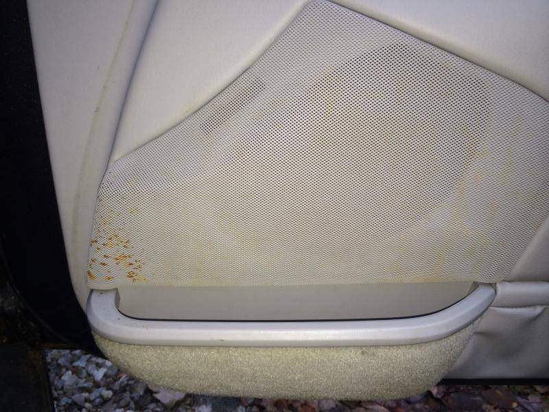

as you can see.. the metal speaker covers arent in the best shape. is there a simple way to remove them? or would i have to take the whole door panel off? IMG_4854.jpgIMG_4855.jpgIMG_4856.jpgIMG_4857.jpgIMG_4858.jpg
you need to remove the door panel off. It's not that difficult to remove, there are screws hidden in the handle and screws in the bottom and in the side.
It's being held up by plastic screws so when you pull it out, pull it straight out otherwise you'll break them.
no i dont want to do anything with speakers, i need to clean up my speaker grills, they have rust on them, and yes they are on the speakers in the back... picture^^^^
I don't think there's a grill there but if you want to remove the speakers, it's fairly involved. Removing the bolster seats, the trim and the carpeting...

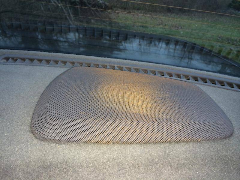

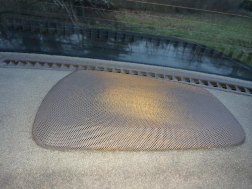

Different years/trim levels had and didn't have grills over the rear subs. My 04 has no sub grills, they just fire through the cloth. My 06 does have grills.
Yes, removing the rear package shelf is kind of involved. I suspect that removing the shelf is the only way to get to the grills to remove them in such a way that they can be reinstalled.

I just realized the 2nd picture is the rear deck grill. Did you try peeking from below the trunk? There's a cover that you need to take out first (secured by push pins only) you might be able to pop it from there but I'm not sure, my LS doesn't have that. If not then it's going to be the hard way.
well thanks for your help everybody, i was mainly just wondering if this was something easy to be done, if i could pop them off simply i would take them to my shop class and sandblast them. even if they're painted(i dont know for sure if they're painted or if that's the natural metal color) i just dont feel like doing all that panel removing just to clean my speaker grills, not in the winter especially, i will wait awhile until im ready to really start fixing the LS up. be a couple months. thanks again though.

Appears moisture has caused discoloration. Soak in 70/30 mixture of bleach/water for an hour. Rinse real good. Paint your desired look. Clear or a different color. Show us pics when done!
Might try a spray bottle with bleach mixture and lightly spray, remembering there is a paper speaker behind there rather than removal of panel. Use a soft toothbrush to help clean. Mask off good then paint with a light coat if needed.
