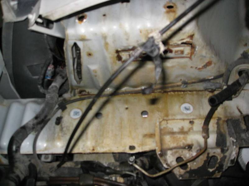

I have a leak from my ABS stuff in the drivers side wheel well. I can't really see much and I guess it will have to come out.
Anyone pulled one lately? Anything to watch for? None of my local Ford dealers have a T90P-50-ALA to do the trick self bleed stuff so I guess I'll have to work around that. I have a pressure bleeder now so I can bleed it down to the fittings if I want. It was the pressure bleeder that showed me the leak.

Check the return line. Its a larger rubber hose from the ABS pump to the master cylinder. There is a chance that the old rubber has failed.
I sure hope so but seeing I was watching a steady drip at 15lb pressure and that there are no drips without and because the supply tube is not under pressure, I doubt it.
Edit:
Well of course I had pressure on the big supply line too. Well lets hope. That will be much simpler than rebuilding the thing.
