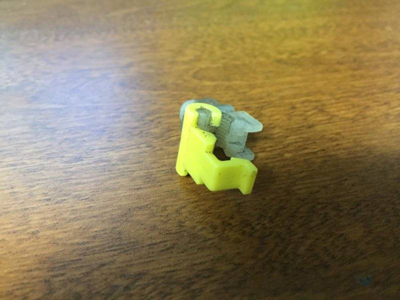

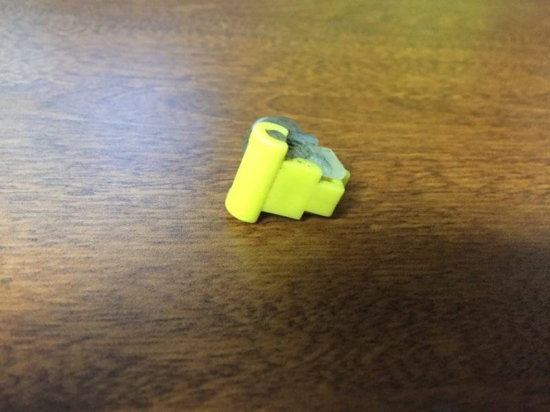

Well I finally purchased a new door lock assembly for my driver side.. ( 3 failing ) I removed the bolts and the wires but there is a little yellow clip that connects the rod coming from the door handle to the assembly it self. Im so stumped I dont know what to do lol.
Does this help?
You have to reach around and unsnap it. Then the rod will be released. The snap is at the small end, the hinge is the big end.
okay thanks I tried that but it wont budge... you mean the yellow part is a lever and you want me to pull square end and not the round hinge end?
Also are they reusable? I have a brand new motorcraft door lock assembly and there is no yellow clip on it.
Yes.
They are reusable in that you can unsnap them and snap them back many times. However, there is some difficulty to removing the plastic assembly from the metal lever of the lock. You have to be very careful and at least a little lucky to do that without breaking the ears that hold it on.

As stated earlier, the outside door handle rod is attached to the door actuator via a yellow and white clip that holds the rod. When this clip is opened, the rod is easily detached from the actuator. Open this clip using a hooked pick that has lots of curvature. Pry up on the yellow part of the clip and it pops right open. Easy. To reattach the rod, place the rod in the white part of the clip and squeeze the yellow part around the rod with your fingers. Again, easy.
