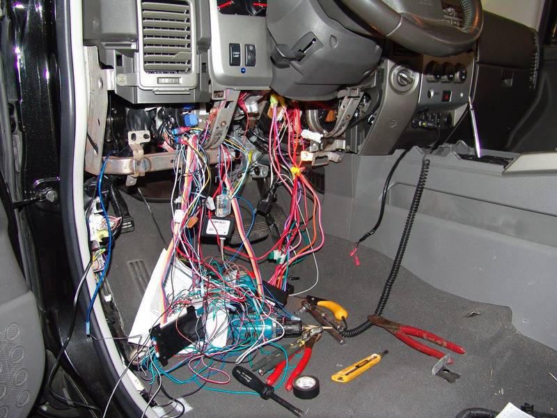

heres my DIY remote start instructions

Wow. What a mess.And I belive you can still roll down all the windows with a remote start, you would just need to hit the open button a few times.

i just threw up in my mouth just a little bit, i dont know what is worse, the T-taps or just the rats nest of wires, nope , its actually the test light being used instead of a DMM
