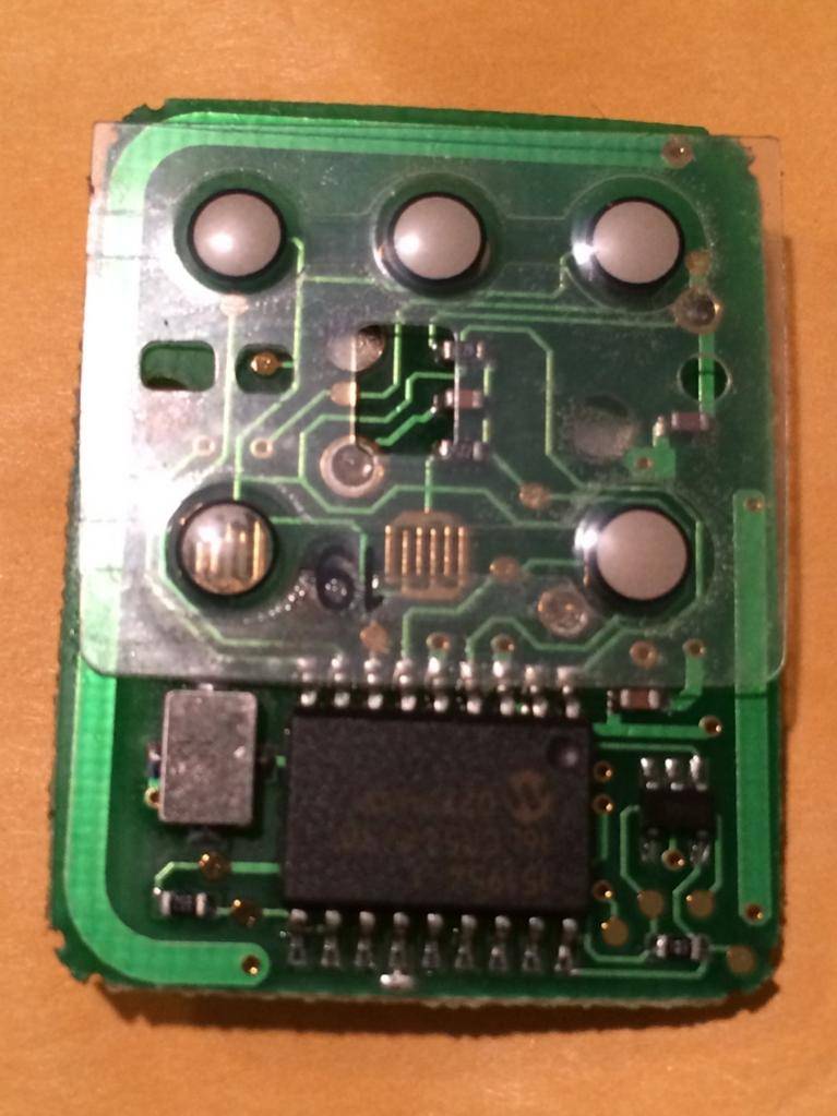

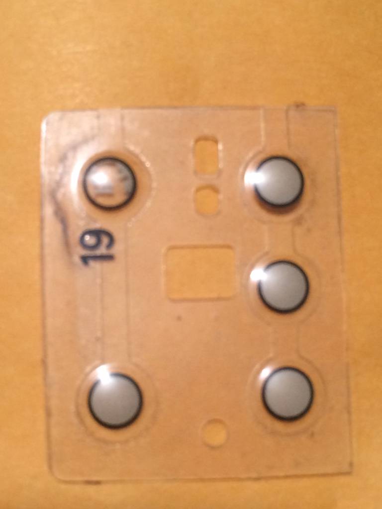

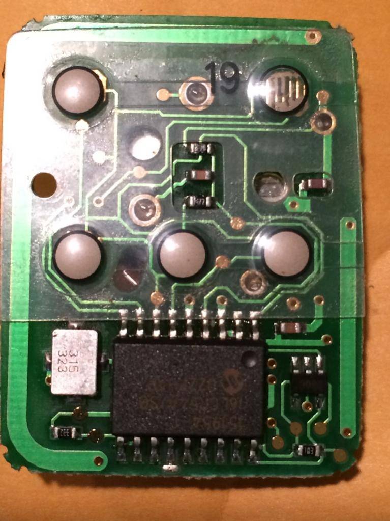

So turns out the issue keeps returning. Upon inspection of the fob internals it appears that the thin membrane part (thin plastic sheet that resides on the underside of the rubber buttons but on top of the actual circuit board) has worn down where the membrane touches the part of circuit board that emits the unlock the car signal. So I basically turned that membrane 180degrees so that I'm now using the nearly new part of the membrane that was previously being used for the rarely used panic button. Long term I ordered two new fobs off of eBay for $8 and will use the new rubber buttons and new membranes from those. I would just use the entire new fobs themselves but I don't want to pay dealership to program them to the car

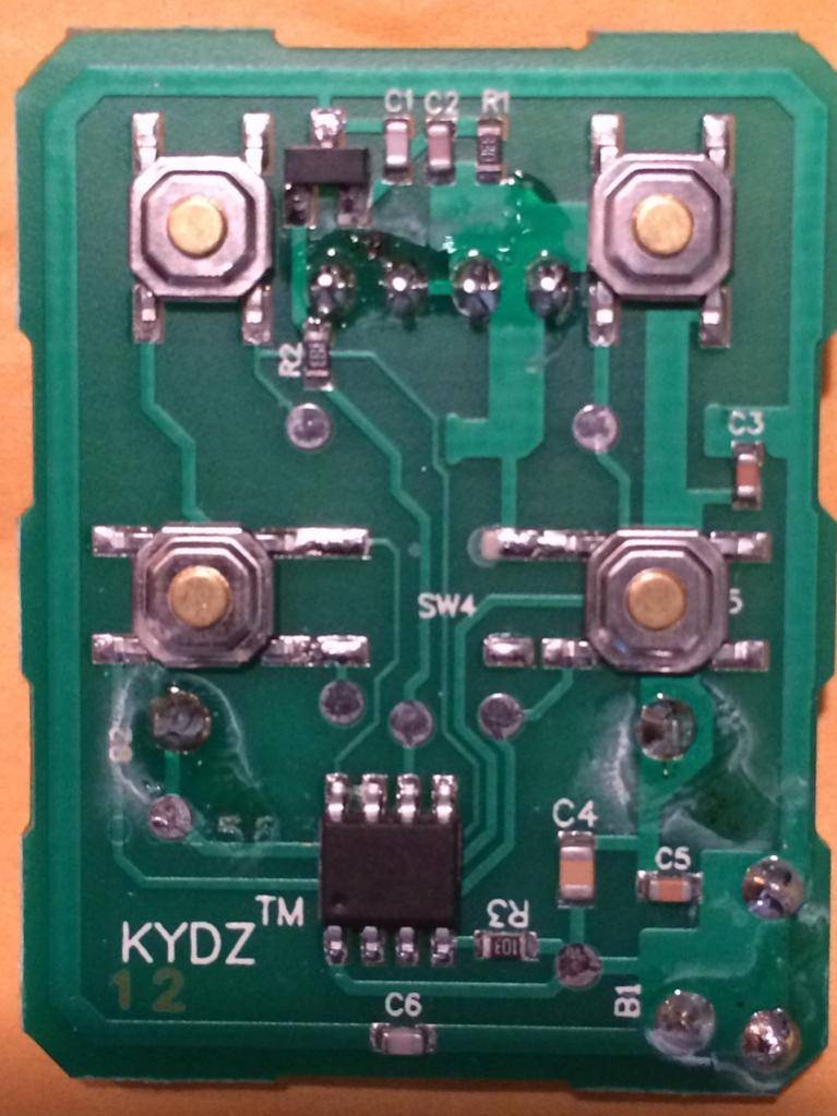

you'll probably get the newer version that features the microswitches. If so the swap will be useless since the rubber pieces are different and has no membrane.

Wish I would have seen this post before the order. Lol. You are mostly correct. I was able to use the new rubber but yes, no membrane on new version. Best solution to my original problem remains turning membrane 180 degrees. Pic on right is membrane in original position and pic on left is after I rotated the membrane 180
A few pics ImageUploadedByTapatalk1412376920.948001.jpgImageUploadedByTapatalk1412376937.557738.jpg
I bought two microswitch remotes on eBay. They look identical to the one you posted, including markings. Both unlocks suck and take 10 pushes to work. One goes to my LS, one I gave to my dad's 03 Taurus. Meanwhile, the other two clicking remotes I have works just fine. They came with the car and have filled-in symbols on the rubber buttons. The sluggish remote has outlined symbols.
