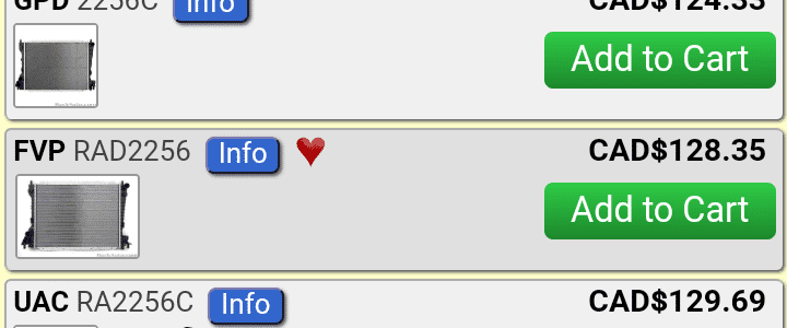

been running FVP for two years now no issue never had a leak since. has good looking thick sturdy constuction. just the pipe outlets are like 1/8 of a inch smaller but thicker,, I used wider clamps with the regular hose n got it real tight.
Third one on rockauto $96USD + tax and shipping.
