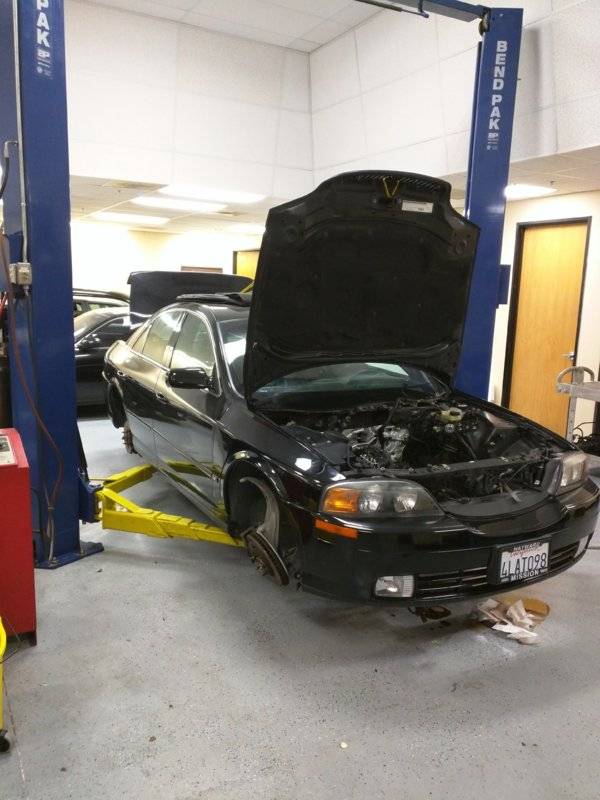

The car is in great shape for a 2001 - giving it to my son when done -

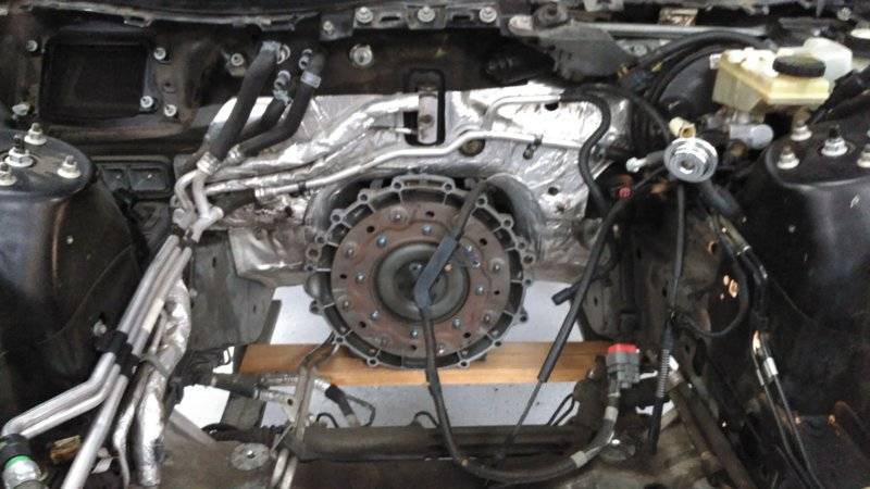

The engine bay without the engine is a roomy place -

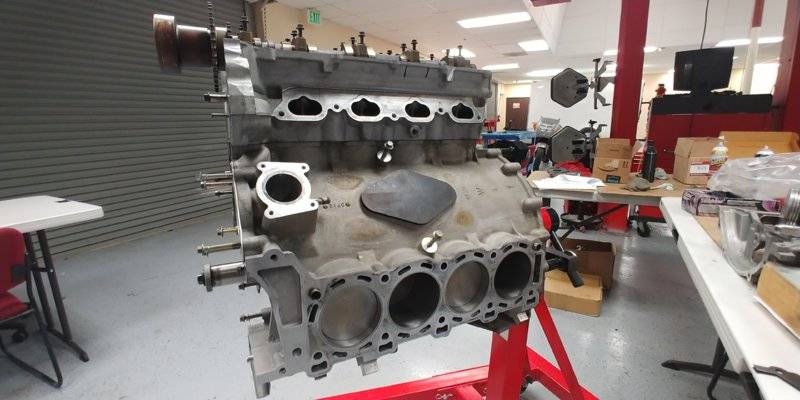

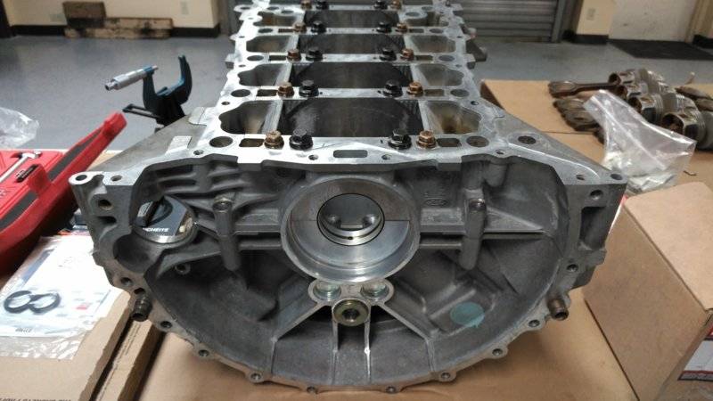

Here's the block bolted together with used (but nice) 2000 Jaguar S-type crankshaft bearings installed - we're going to see if it all specs correctly -

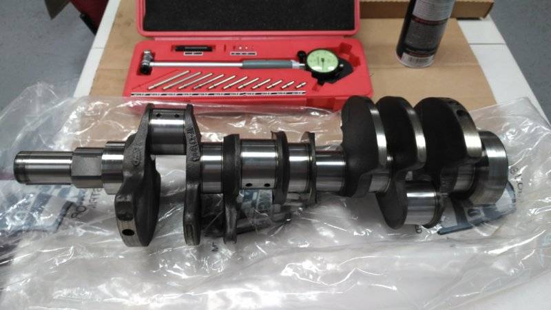

Here's the used crankshaft all the way from Texas back from the machine shop for polishing - now to measure and make sure all is still well -

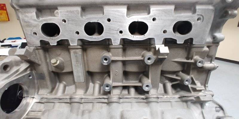

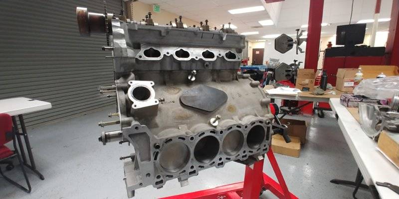

With the crankshaft and used (but re-ringed) pistons - also from Texas in the engine it's time for the first head -

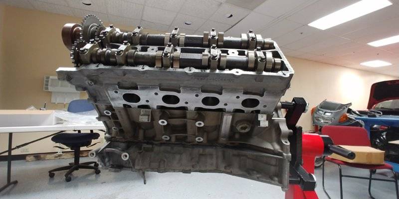

Here's a another view with the intake and exhaust camshafts installed -

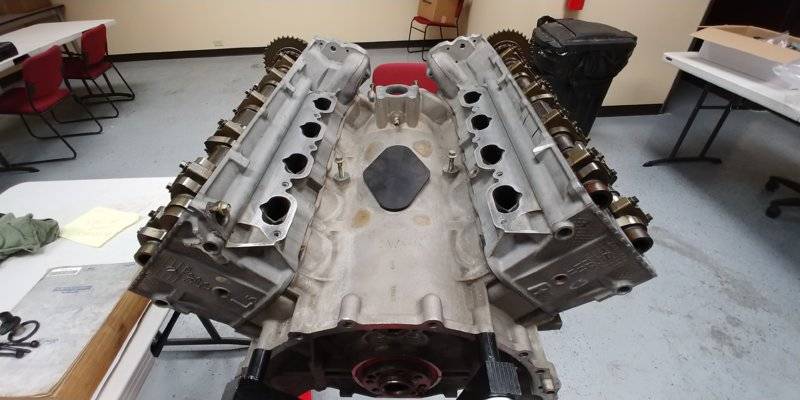

... and now the second head goes on -

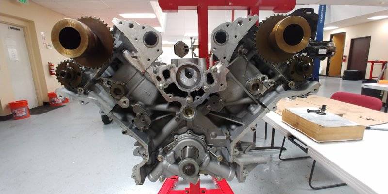

So this is where we are today -
So now its time to install the timing gears and chains ... hopefully I will not need the specialized tools the manual calls out for this process. If necessary, we will improvise, which seems to be a requirement when re-building these Anglo-American engines!

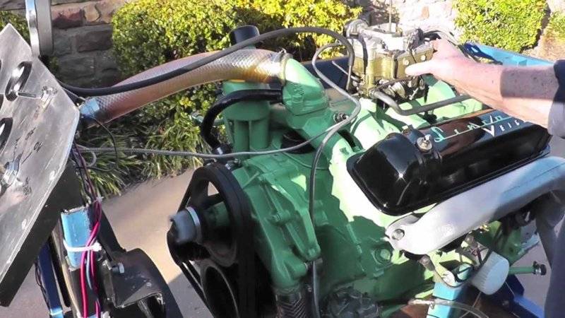

Stay tuned and get prepared - when it's all back together I'm giving it a retro Lincoln V-8 paint job like this before it goes back in the car. Why paint a 2001 Jaguar/Lincoln/Ford 3.9L V8 the same color as a cast iron 1953 Lincoln? Why the hell not?
