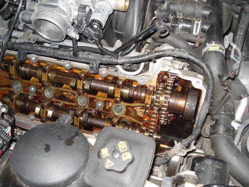

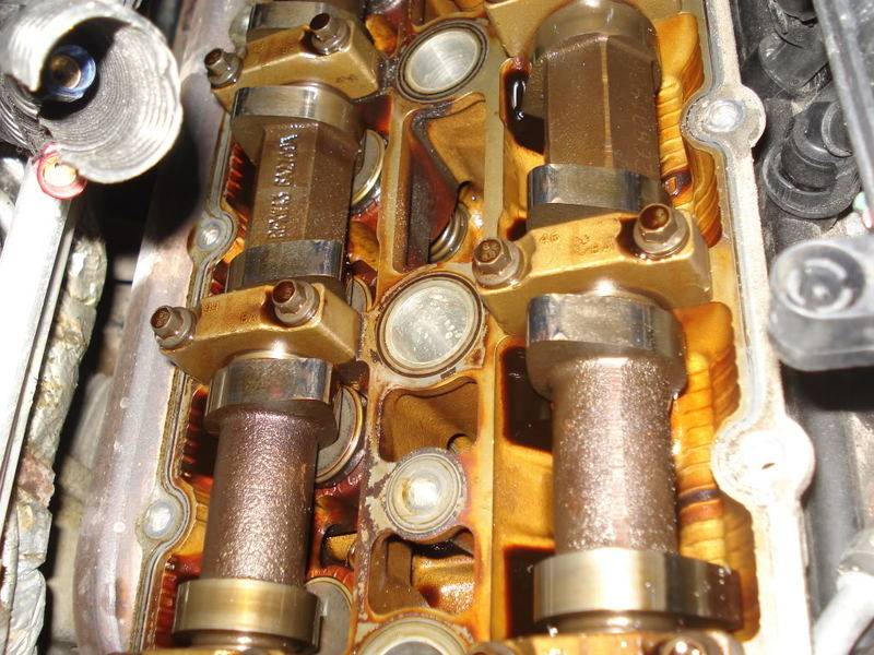

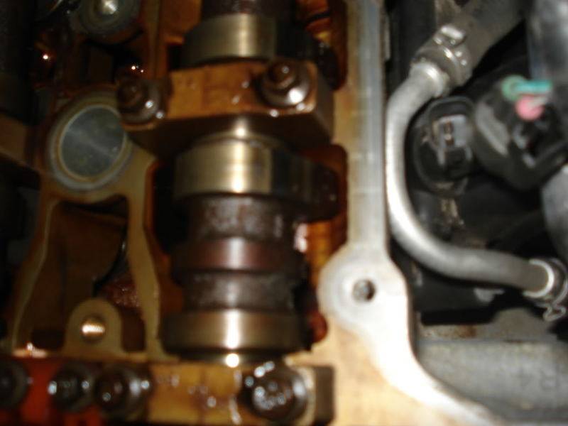

so tonight I started to change my VCG's and coil/plugs. Here is where I ran into my biggest fear. I got the passenger side off and almost deficated myself! The valve train looks like dirty bung hole! Somewhere allong the way, i got some serious oil burned onto everything. Its now where I'm trying to figure out what to do. I really feel like taking the top end apart, cleaning, and inspecting it. If the valve train is this bad what does the rest look like. The other thing I was thinking about. I have heard of a few oil cleaning methods that may help without having to rip everything apart. I was concerned with the age of the motor starting to catch up with me. Honestly if the motor blows, I'll either ditch the LS or drop a less expensive motor in there..... like a Cammer FE LMAO!!!! But this motor is light weight and is more than capable of good numbers with reliability above most others available today.
I digress. I need some thoughts on this. I want to clean up the valve train. Rip her apart or treat the oil with something?

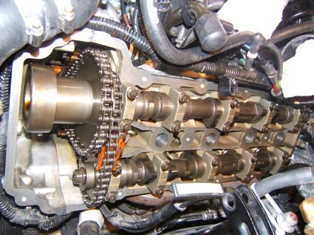

how bad is it?
post up pics.

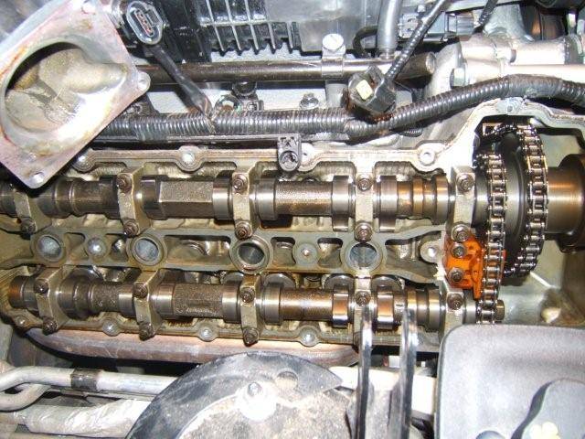

Here is what mine looked like:

in those pictures.... nothing is wet. its all dry even the dark brown parts that look wet

SPSully, that isn't that bad at all. I have seen motors 400x worse that that and still be running fine.
