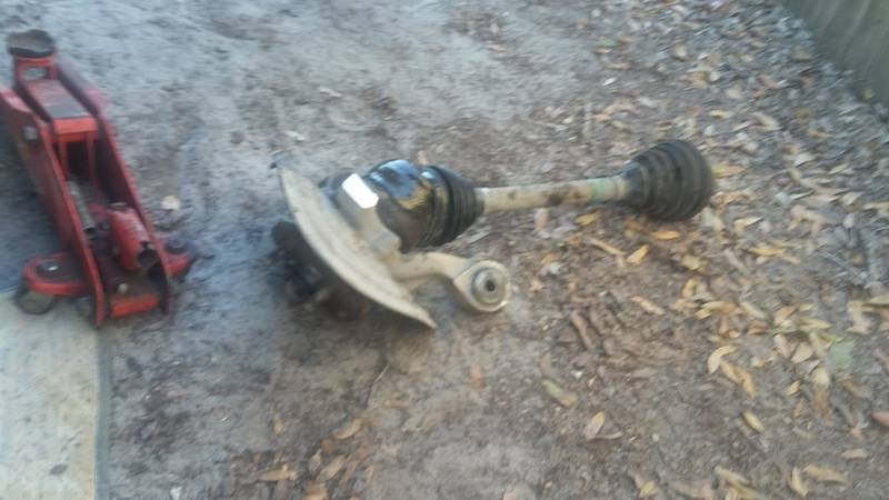

Yea I bought the whole knuckle looks like 3 just not sure how axel comes in and out of it.

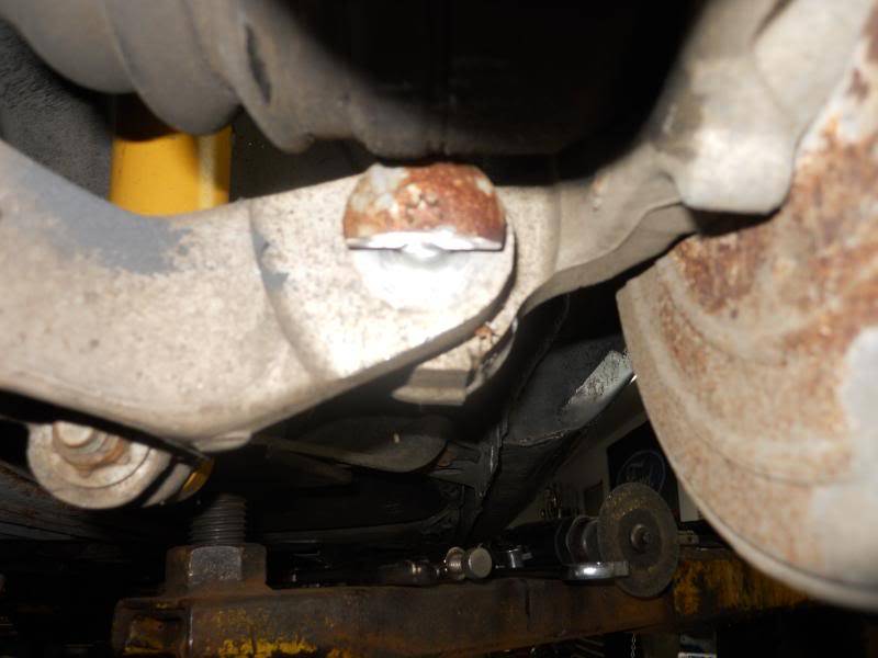

not easy for sure, cant get the axel to move, the bottom left bolt to clear.
What I do is cut the flange off that bolt half way. I run them back in both my Mk8's. I can look for pic to show you what I mean if you want. You could quickly fix this by just putting in 5 new studs and be done.
Well not now I can I have that arm that holds that bolt half sawed off. I went and got a 7 ton wheel puller and tried to push that axel out ended up messing something up in the drive shaft. I should be able to finish cutting that arm that holds the bolt you cant remove and see whats going on in the drive shaft. I may call the yard and get the drive shaft the hub came from not sure UGLY JOB

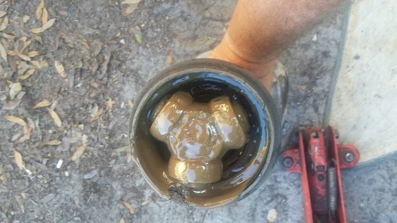

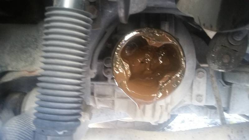

I am looking at were the cv joint goes into the pig and when I turn the hub it is slipping like its not in jumps like two teeth kinda feels like in needs to be pushed in.
I am going to remove the black boot and see whats up but would like to see a tear down picture to see how it works or what I should see. If I can get it out of the pig I think I am just going to call the yard and get the one they took the hub off of.
What if anyone knows is the removal process of the cv joint from the pig
You just pop the axle out of the "pig" lol. Use a screw driver or pry bar. Go right in where axle is almost touching pig and pop axle out. See this is why I asked you to just replace the 5 studs and be done. Job would have been done in hour. You need to start takinng pics and posting with your ?'s it will make is easier to see what you mean.

You just pulled the cv joint apart thats all there no biggie just put them back together. There was no need to cut that arm. You just cut some of the head off the bottom bolt you could not slip out. Once you trim bolt head it allows bolt to now slip past CV shaft and come out. Just pop the CV inner shaft stub out of the "pig'.
I trim bolt head with cut off wheel. I loosen bolt so head is away from alum arm when cutting head. Once cut is done roatate cut so its up and then push out bolt. When I reninstall cut bolt I put it in backwards.

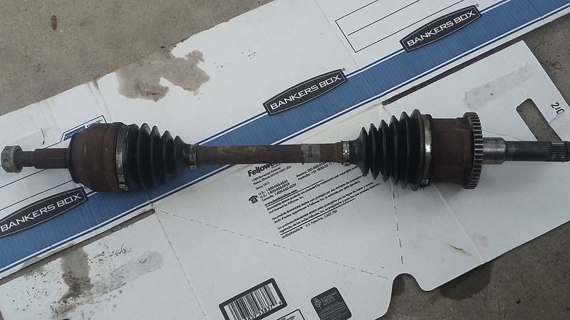

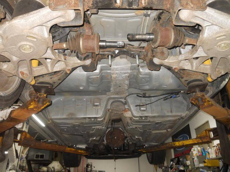

Here is what pig ends of axles look like, You can see "c" clip on very end of axle. That's what "holds" axle in pig.
Thank you so very much, my friend took it and see If he can get the shaft out of the hub, I will try to remove the rest of it Or do I need to? Can I just push the rest back in?

The gen 1 and 2 axle center bars are different dia's by alittle but does not matter, I put Gen 2 axles in my gen1. You should pop that stub out of trans nothing will leak out of pig. You will have to anyway when you get new used axle. The cv boots have to be banded/clamped properly when putting back together. Any cracks/leaks/holes will THROW out the grease.
