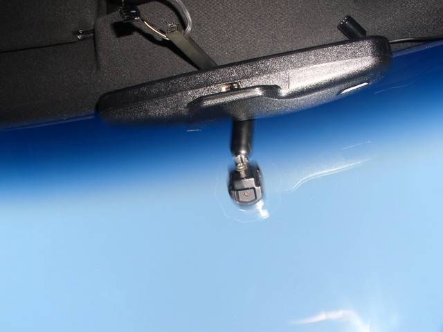

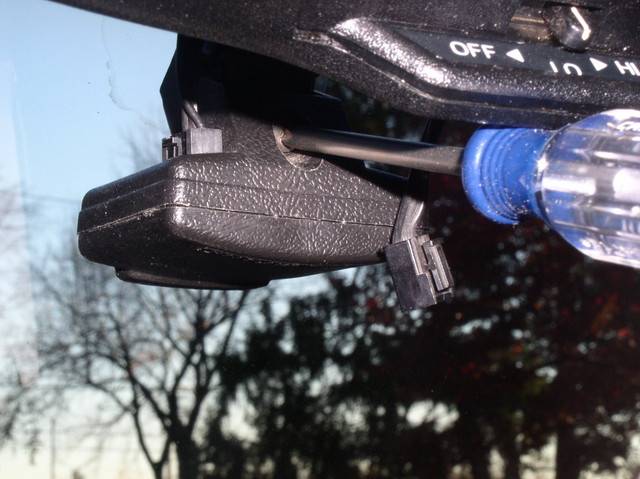

Tilt the mirror up as if you want to see the sky. Get a flashlight and shine it on the top part of the light sensor box. See that hole? There's a phillips head screw in there. It attaches the sensor to the mirror mount.
Remove the screw and the sensor. This reveals a tiny hex-head set screw which attaches the mirror to the windshield mount. I suppose you have a loose set screw.
The tricky part is removing and reinserting the phillips screw. On mine, the mirror is in the way and a straight screwdriver won't fit. So, I use one of those double-headed flat/phillips Z-shaped screwdrivers. Upper left of this photo:

Use enough grease/gel/toothpaste on the tip of the screwdriver to temporarily hold the screw to the driver.

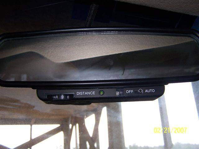

Very cool pix OldSchool1.. worth many thousand words. I see you have room to get a screwdriver in there, and I notice my mirror is different.
Mine has stuff all the way along the bottom.. a wheel-type distance adjuster (from 1 to 9 and "FAR").
The light sensor is next to that (not up in the corner of the mirror). The on/off switch is to the far right.
'88 mark 7, LSC, 5.0 HO engine .. abs .. no sunroof.. all stock as far as i know.

I see you have room to get a screwdriver in there, and I notice my mirror is different. Mine has stuff all the way along the bottom.. a wheel-type distance adjuster (from 1 to 9 and "FAR").
Whoops ... those are the 1990 and up pictures above.
The 1987-1989 automatic electronic motorized mirror looks like this and should be removed similarly:
I like stock.
yup.. that's my mirror. I might get a stubby screwdriver in there like..
