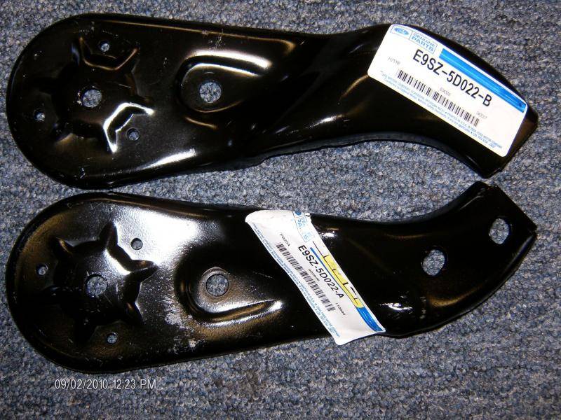

Just found my rear subframe brackets are rotted out but the mount is in good shape. Where can I find replacements other than searching junkyards? anyone have any to sell? send a pm if you do.
not too long ago, they were available new, and not terribly expensive either.
AFAIK, They're still available new for around $15 each.
part numbers:
E9SZ-5D022-B (left)
E9SZ-5D022-A (right)

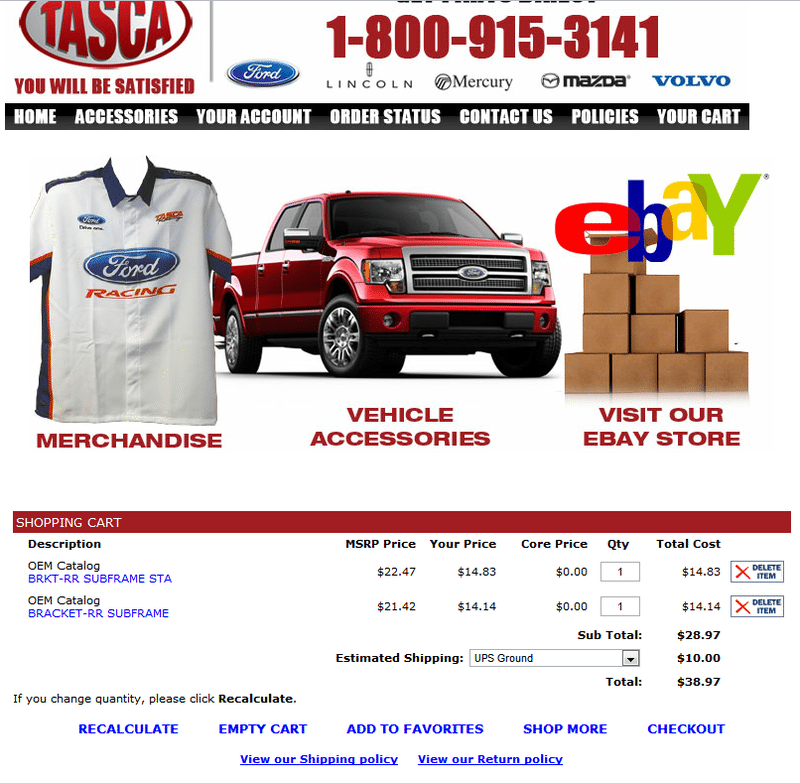

tasca parts has them at about $14 a side + $10 shipping.
shouldn't be hard to find a set.

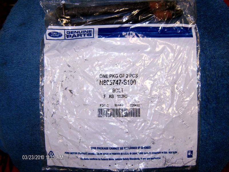

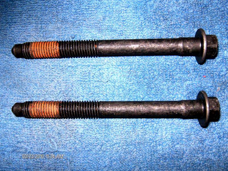

Does anyone have the part numbers for the bolts?? I cant find them anywhere. I am really not looking forward to this... looks like a nightmare. (I live in Missouri.. RUST HEAVEN)
N805747S100
BOLT-M12X1.75X129.5
Sadly, they're discontinued. :(
