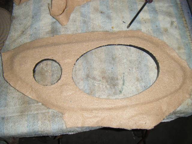

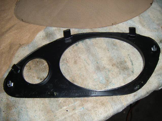

I've always had various annoying noises in back due to the rear speaker grills. I tried fixing it once by putting strips on velcro (Soft side) in between the grill and mounting plate with foam weatherstripping between the panel and grill assembly..It didn't work.

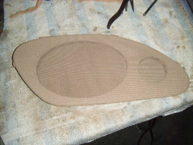

Fast forward to today. Decided to utilize some thin tan fleece like material between the grill and mounting plate while cutting it oversized so that I could wrap it back around the grill flaps to help reduce the noise. I think wrapping it back around the grill covers mounting flaps made a huge difference as they do make contact with the side panel. I used a lighter around my cuts to clean up the frays.
It's a pretty firm fit now with little movement and A LOT quieter. Should've done this 8 years ago. Sigh.
I did the same thing but...Nice work!
For how many times I've taken them off and them back on I guess they just got a little worn out. That and the original cloth between the cover and base disintegrated the first time I took it apart many years ago. It turned out very good for an impromptu repair.
