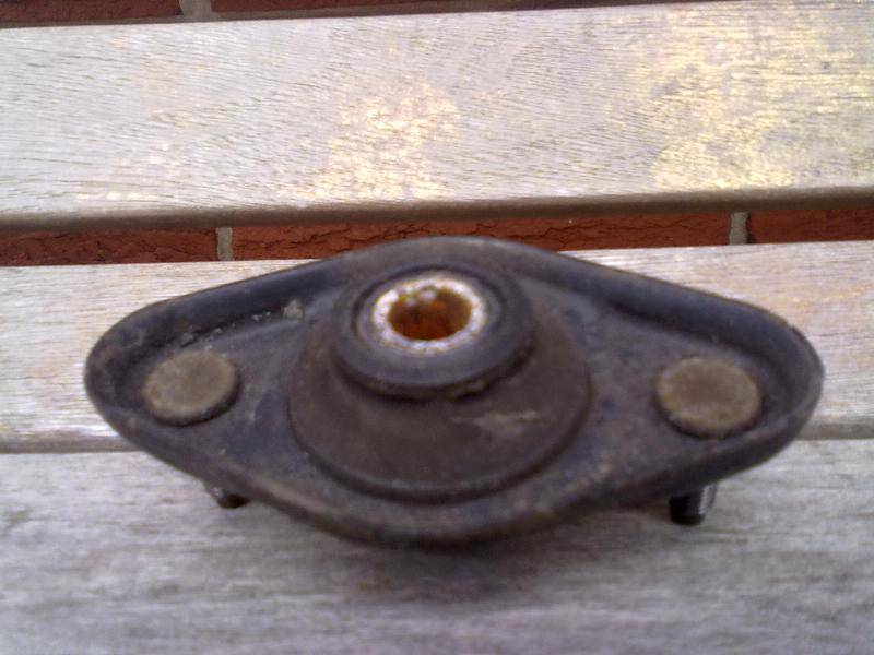

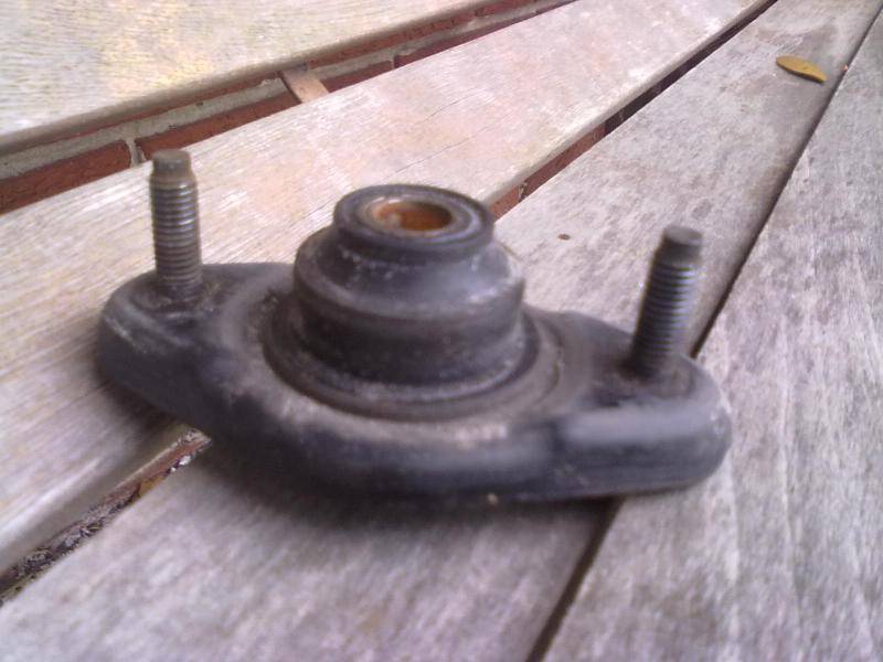

So i know there was a post earlier today about the same thing but I need your guy's opinions on this. I was getting the infamous clunking noise in the rear and was told it was the rear shock mount bushings. I finally got the time to get my stuck bolts of the mount off and finally got a chance to see the mount. The bushing to me don't look bad at all but i have an untrained eye. I have the bushing that came with the shock but burning the bushing of this mount seems pointless since they look like they're in very good shape.
You can see in the last pic that it is bad
x2, see the crack and befor you spend $100 just take a blow torch to the old ones to remove the rubber and get some tbird bushings and washers. mine came with my tokico blues
I got my rear shocks and the Polyurethane Rear Shock Mount Kit from supercoupe's for $50.00 for the mount kit. They fixed the problem I had and ride great.
