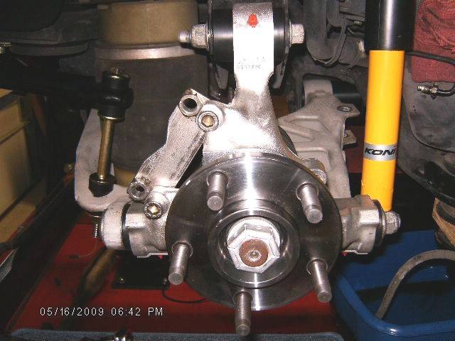

Some have used '03/'04 IRS Cobra shocks (OEM Bilsteins), but you can look for any '89-'97 Thunderbird rear shocks. I went with Konis.
WTF, DLF, there's dirt on your air bags there...you're slipping....:D
