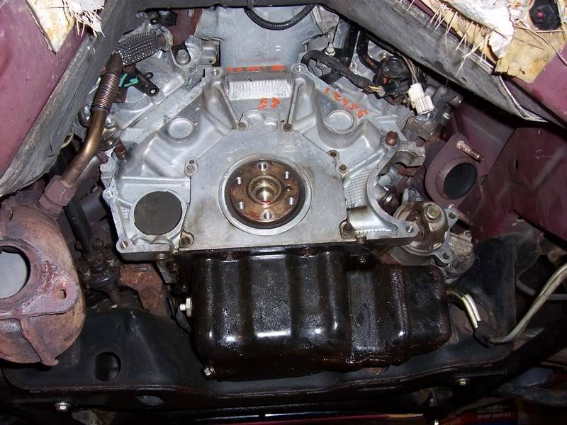

rear main seal?

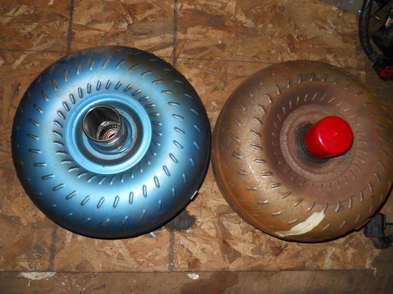

Here is what the torque converter looks like.

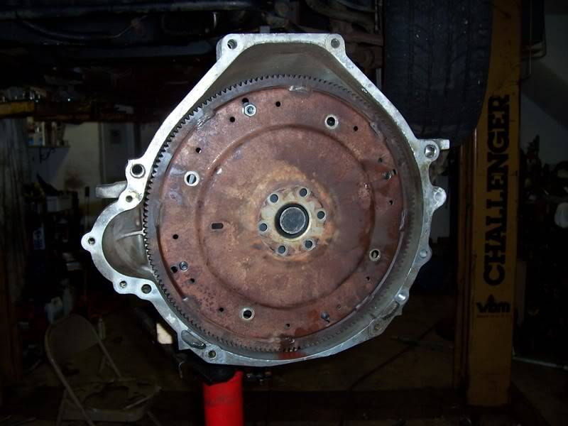

Here is the flexplate still on the converter and off the crank.
Here is everything off and you can now see and remove the main seal.

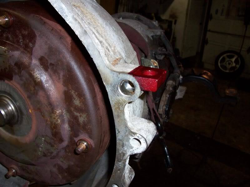

If you have a Gen1 this trans tab I marked in RED will hit the EGR tube and make trans a B to remove. Cut this red part off trans before putting trans back in.
