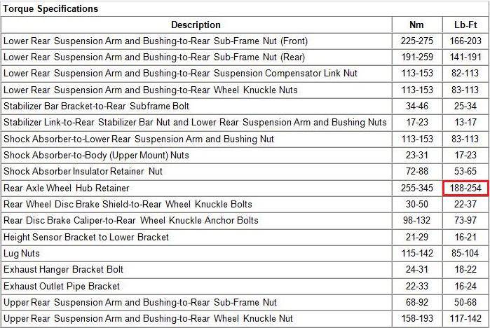

So after putting on the new hub I drive out of the driveway and before I get to the end of the street I hear noise from the back left again.
I figure either the half-shaft was damaged or I didn't torque down the nut tight enough.
I torqued the nut to 150ft- lb's and then gave it all I had to rear the torque setting. I didn't use a cheater bar or anything.
Tomorrow I'll get a big breaker bar on that thing and give it a go...

After I put the new hub on and tightened it I did the same thing and there was no play... is it possible for the hub to be giving me noise right away if it wasn't torqued down correctly (which I will remedy tomorrow) but should I be looking at a bad half-shaft.

I torqued it to 140, then to 150.. figuring the difference there and how hard I was already pushing ( I figured I didn't have enough strength and leverage to hit 250 ) I torqued till I thought I was in the range of .. what is it 210-250 ftlbs.
I'm going to rent a torque wrench today and see what it's set at. I could have very well damaged it... I've done dumber things in the past.

Ok guys. Wanted to update you. Tested the torque with a big torque wrench that actually went to 250 and it was torqued to 230-240. It was well within the range of the suggested torque. But, after driving it a bit more it was obvious that it wasn't the back hub. It was the front right hub. So... after a new front right hub the car sounds great.
