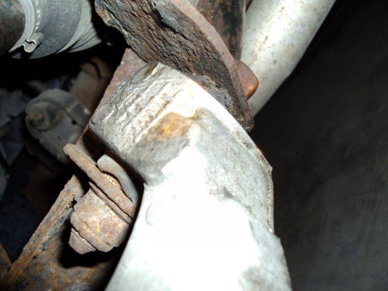

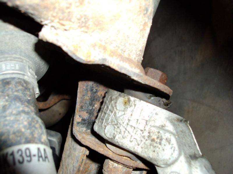

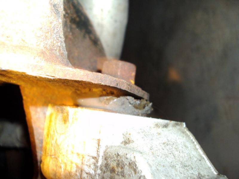

Looked at the lower control arm after work and this is what I found:
Pretty sure I can't inject these with anything since they look like they exploded. And yes the car is rusty underneath, it has been driven for 11 years in PA.
Checked the passenger side rear and they looked the same practically.
Everything else under there looked alright.
