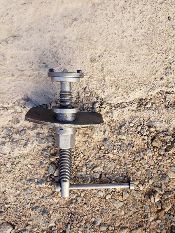

What's the secret to compressing the rear calipers? Fronts are easy, rears won't move at all. Thanks
Nevermind, I figured it out. You need one of these babies in case anyone else is wondering, the rears turn in, weird.
You need a caliper tool that rotates the piston clockwise as it pushes in on it. Just trying to push in on it won't work, and will possibly damage the caliper.

Needle nose pliers work in a pinch. It won't be as efficient as the tool but it gets it done, just place it in the slots and rotate while pushing in
The proper tool that Sultan has... works much better... and is faster and easier.
EXACTLY !!!
Yeah I tried needle nose, didn't really work very good so I went to AutoZone and rented that tool for free.$65 deposit but I got it all back when I returned it.

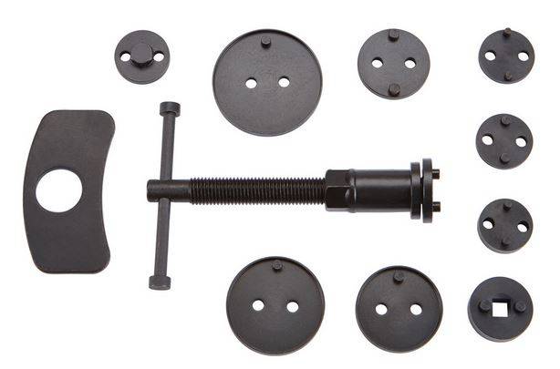

If you want the tool Harbor Freight has a pretty good one that I have used on a number of cars. It's $50 but with a 20% off coupon you can get it cheaper. If you can find the coupon!
Disc Brake Pad and Caliper Service Tool Kit 11 Pc.
