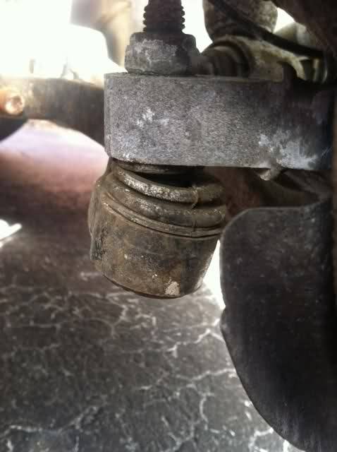

Also I know my tie rod ends are bad, but is this gap sketchy looking or is it me? Should I try to crank that nut down?

Don't "crank that nut down." It's a one time nut and you will have to replace it (and any others on the suspension) if you move it. This is because of the aluminum suspension parts. If you don't the nut will spin itself off after a little while.

Also I know my tie rod ends are bad, but is this gap sketchy looking or is it me? Should I try to crank that nut down? ..........
If you're asking about "crank that nut down?" then you haven't done any suspension work before. I really would suggest you do a lot more reading about how a car goes together and possibly have a friend who has done this work be with you, or just take it to a mechanic. While doing DIY is a good cost savings and learning method, it can get you into a whole lot of hurt both in the pocketbook and with vehicle safety.
That nut pulls the tapered part of the tie rod end into it's corresponding tapered hole in the knuckle. Tightening it down will do nothing for the damaged seal on the tie rod end.
I would have been a lot more comfortable about you if you had asked how to deal with the seal issue rather then going directly to cranking on something.
I didn't crank anything down man, this is why I asked here first. Trying to discourage DIY to me is atrocious. You are correct in assuming I have limited suspension experience. All I have done on suspensions is ball joints. However I don't crawl under my car and wing it and start turning bolts without seeking input first. :rolleyes:
