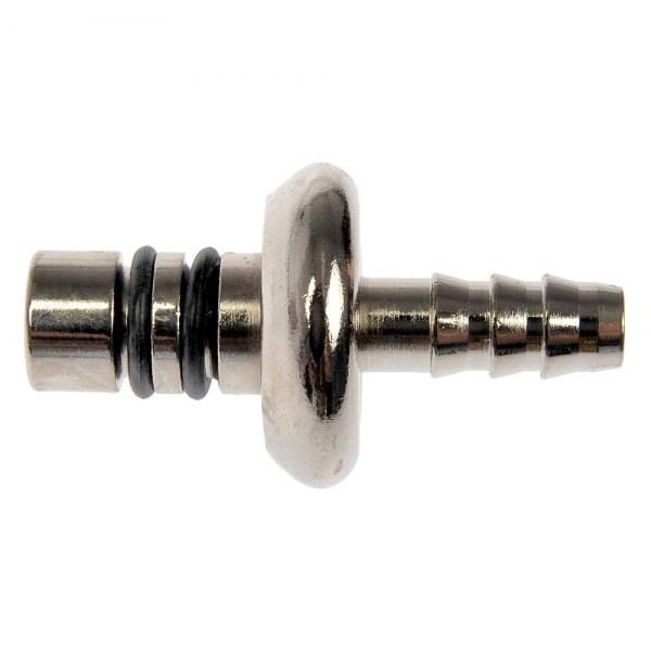

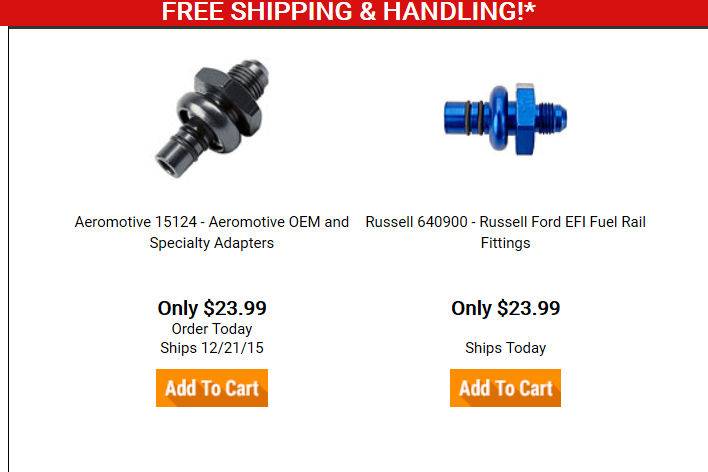

Did you substitute the OEM spring-clip to hose barb fuel rail connector with a spring-clip to AN fitting adapter?
I don't believe the pictured fitting was available at the time I did my job. I brazed together parts of the two fittings necessary to make what you're showing.
