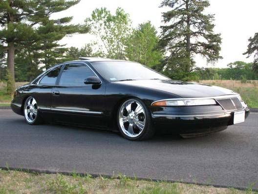

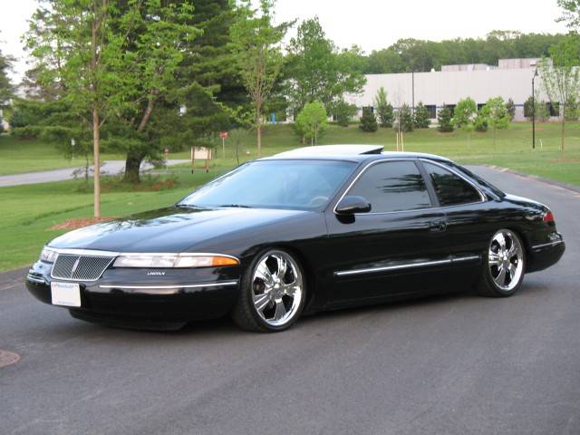

i did the kit a few months ago, install was easy, cut 2 wires and install the ends into the butt connectors and splice into 4 (i think) wires and 2 powers and ground and watch it drop!!!!!!!
Nice ride, looks good slammed :cool:
yeah thanks, it just takes FOREVER to come back up im trying to figure out how to put an air tank in it
