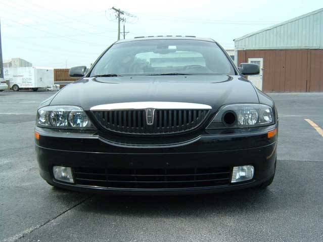

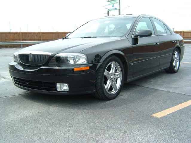

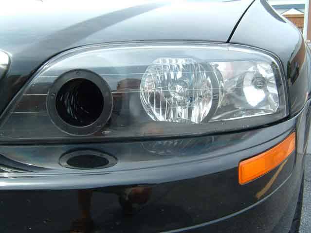

heres an idea for you.
not street legal where I live, The cops would line up to hand you tickets for that.
And QuikLS's hood has an NACA Scoop fitted to it. It doesn't have to stick up above the surface of the hood to be a scoop.
i know, i was just messin around. but that is about as ram-air as you can get without modifying the hood.
That's pretty cool. Any water issues? Can you hear it? Let's see some under the hood pics. Very creative!
This is the only under hood pic available, this car is long gone.
No water issues at all, there was a 1/2" hole drilled into the bottom of the air box to let water drain out if any got in at all. You could hear it, which was cool, it was sucking in air and you could stop the motor running by putting your hand over it.
This mod cost like $30 by buying a used headlamp off Ebay and routing the tubing through the head lamp. Cheaper than cutting the hood up.
